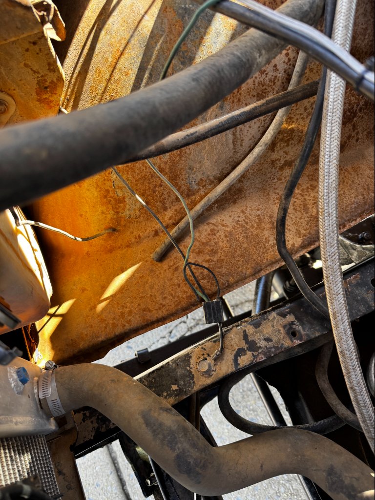

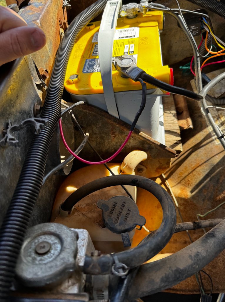

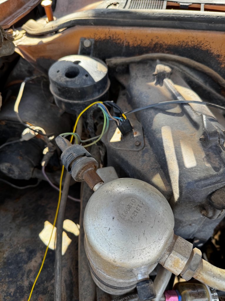

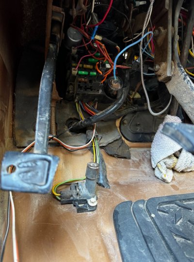

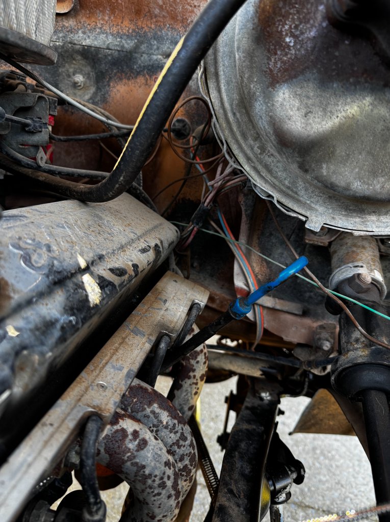

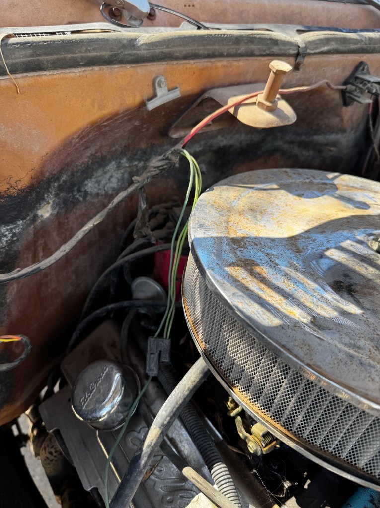

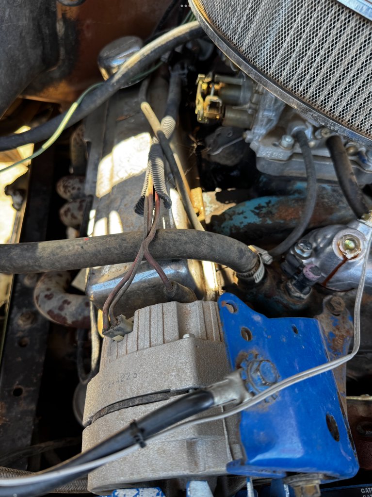

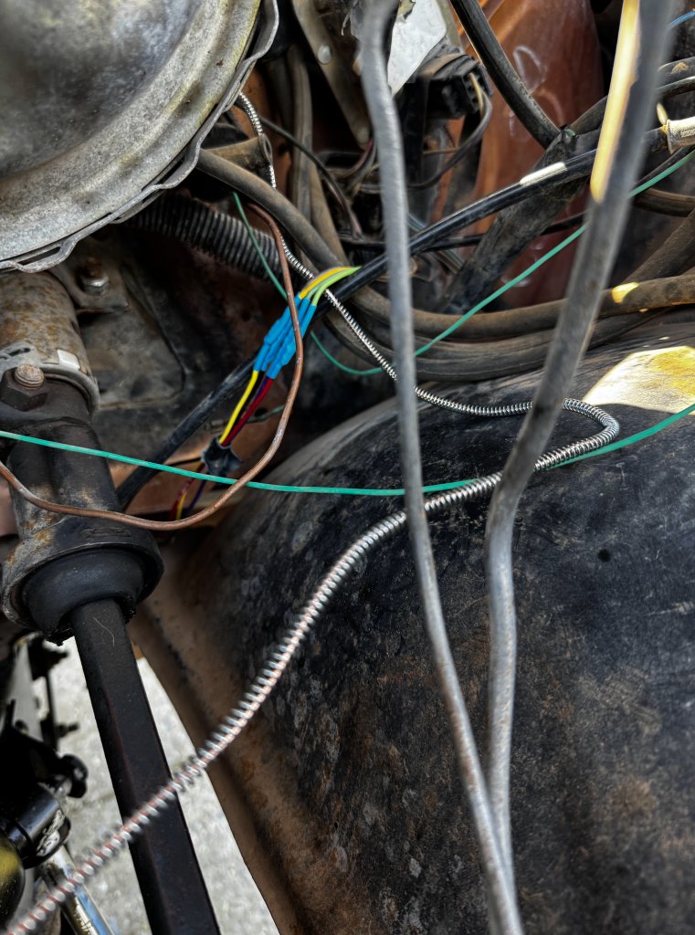

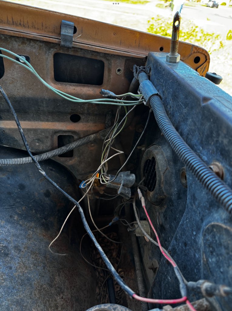

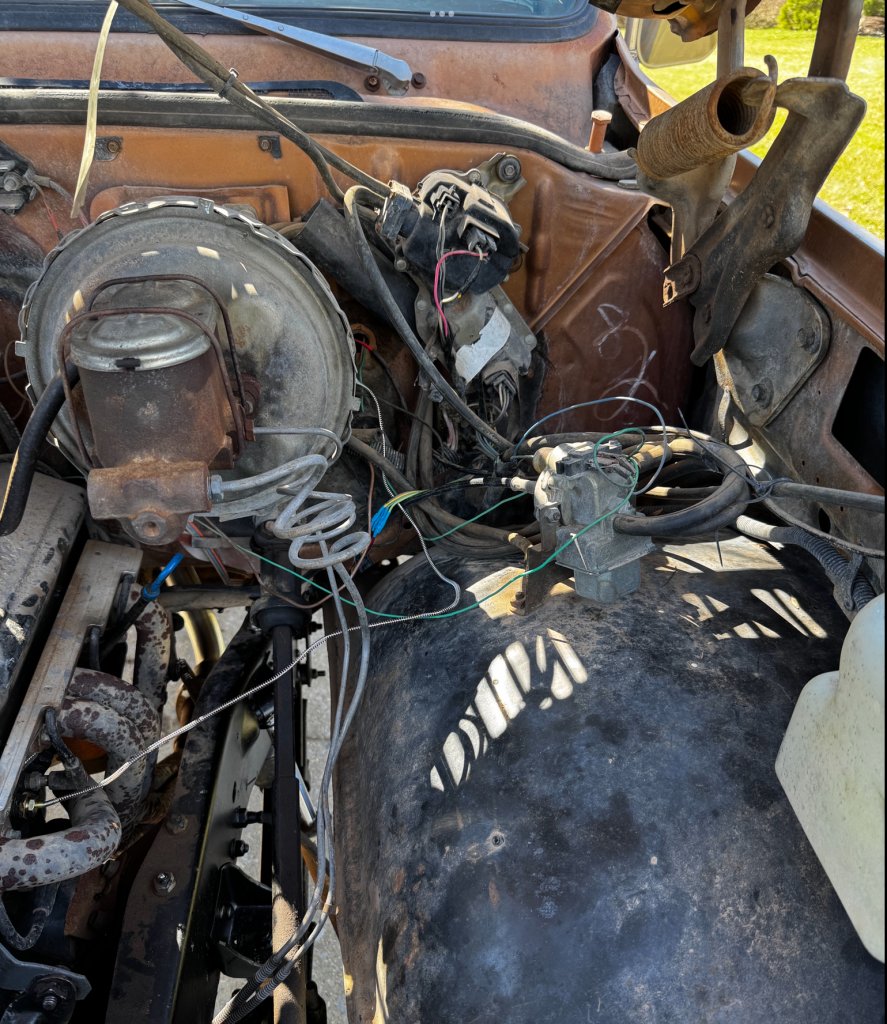

Good evening guys. I may have mentioned this before but the wiring in the Burb is an absolute mess. Literally there are just loose wires hanging everywhere. As a result I am thinking that it might be best for the long run to just rewire the whole thing. I have seen a bunch of people recommending Painless. Does anyone have any experience with Painless or any other brands and do you have any advice or recommendations. Thanks as always for all your help and advice.

I think my buddy used a painless harness in his 75 K5.
Got some pictures of the wiring mess (we like pictures)?
Looking at some of the previous pictures you shared appears to have aftermarket gauges/tach and a din radio cut in.
If the spaghetti wiring is from the added on stuff, and the OE harness is mostly unharmed, and functional I’d just clean up what’s there and tidy everything up. If the factory harness has been chopped up a bunch I’d lean towards a replacement.
Just my 2¢.

You may be right and TBH I don’t really know enough to know just how bad the wiring is. I just know that there seems to be wires hanging everywhere and I had to rerun the rear break light wiring.

Wiring Photos 1
TheHoundsman
Dec 12, 2024
107
262
West Deptford NJ
Brian
Chevy Suburban
350 V8
Photos 2
