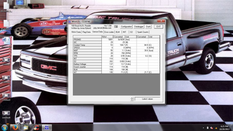

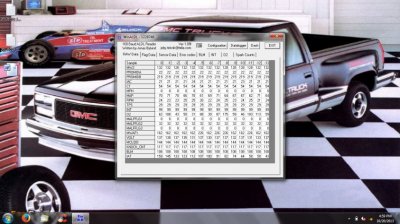

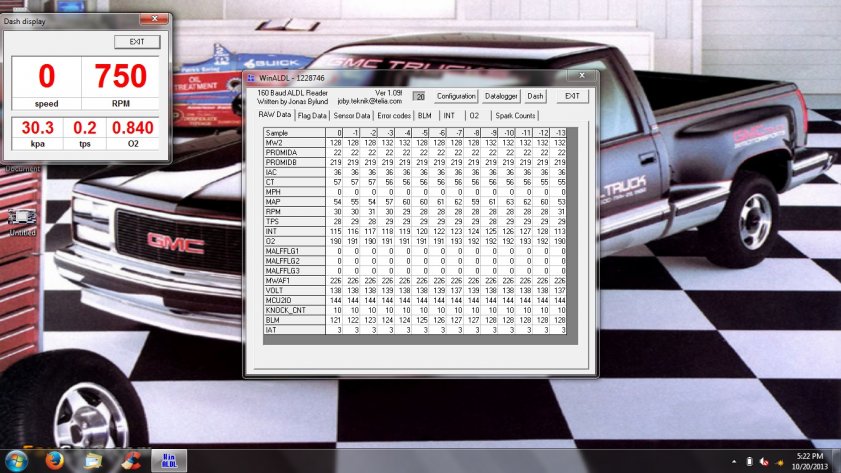

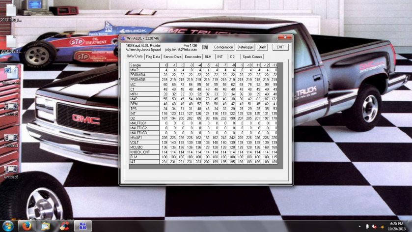

Optimal BLM is 128. The lower the number, the richer it runs and the higher the number, the leaner it runs.
Still getting a code 45. New o2, CTS, thermostat, cat, MAP, EGR and solenoid, rebuilt TBI.

Why is there an IAT reading?

Why is there an IAT reading? BLM and INT are both low....the ECM is asking for extra fuel for some reason.
