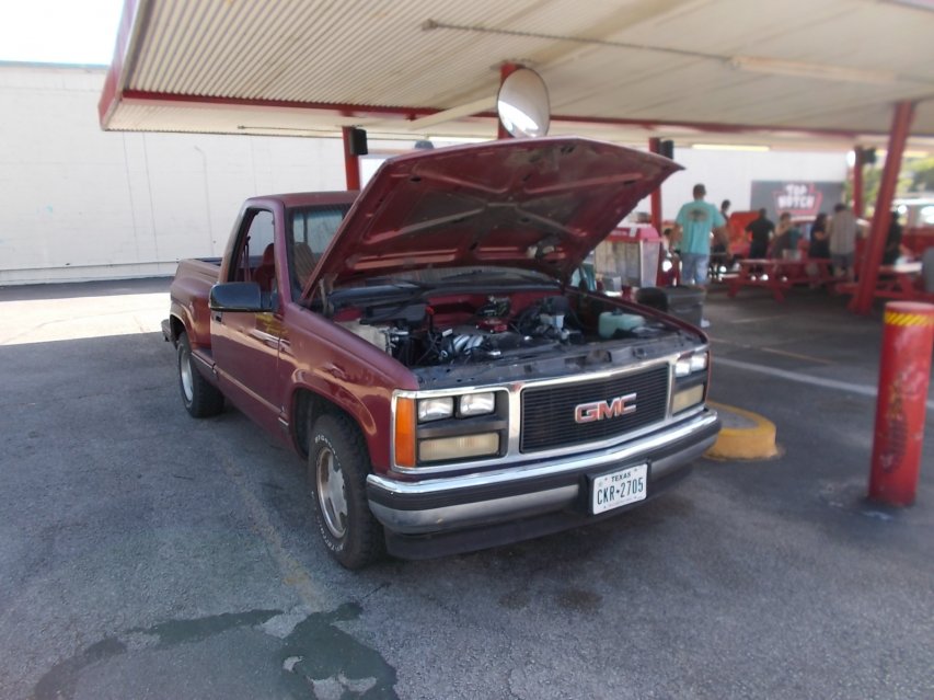

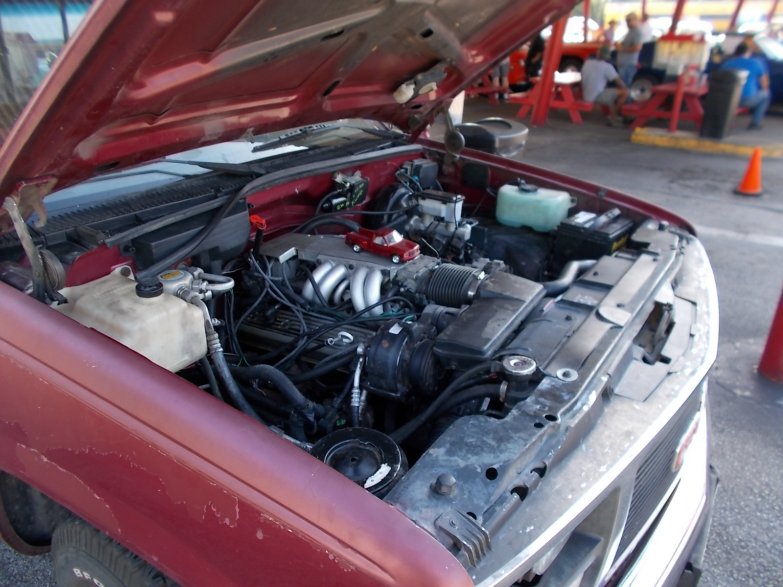

Hot Rod night at Top Notch Hamburgers. There was another TPI truck there as well, an early 50s Chevy.
