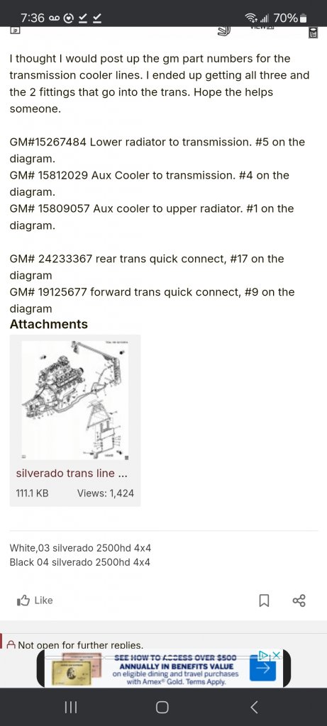

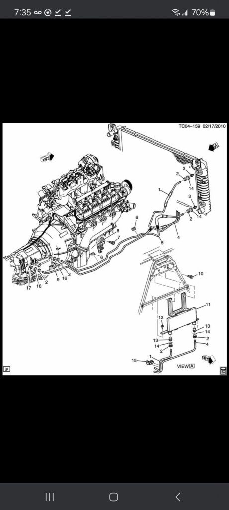

Factory gm used radiator cooler and auxiliary cooler plumbed in series. I think was a 2018. It's how I've done them for decades. Maybe I'm right maybe I'm wrong just how I was taught at work.
You are definitely right about that. I can't remember seeing a vehicle with an aux cooler that wasn't plumbed in series from the factory.
