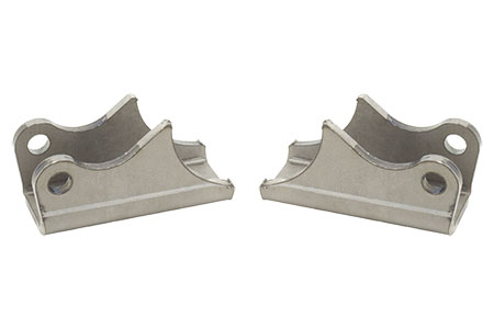

1978 K20 14 bolt 3" block lift 33" tires. I would like to relocate the factory mounted shock brackets that are welded to the axel tube, they are hanging below the tube and I want to relocate them higher on the tube to gain more ground clearance. Where can I get my hands on a pair of those brackets. If anyone has installed these any information would sure help.

easier to carefully cut them off as close to the axle tube as possible and then flush the weld off, clean off your new area, reshape and weld again.

DIY4X and ORD sell weld-on mounting tabs. Or you can just cut off the old ones and weld them back on in the position you want. Honestly, with a 14BFF I'm not sure how you could possibly hit anything with those brackets where they are. Do you have a 13 bolt shave kit on it already?

No shave kit. Stock 14 bolt 3/4 ton 1978. The shock mounts clearly hang below the axel 2-3 inches. Ill check with ORD and DIY, thanks for the info.

I would think something as simple as a shock mount could just be made pretty easily out of stock steel, but maybe getting the axle tube circumference just right is an issue?

There's a reason they hang down. Move them to the top and you lose 3 inches of shock travel. Better off chucking those lift blocks and doing a proper lift. Two wrongs don't make a right.

If you raise the bottom of the shock upward, you will loose wheel droop.
