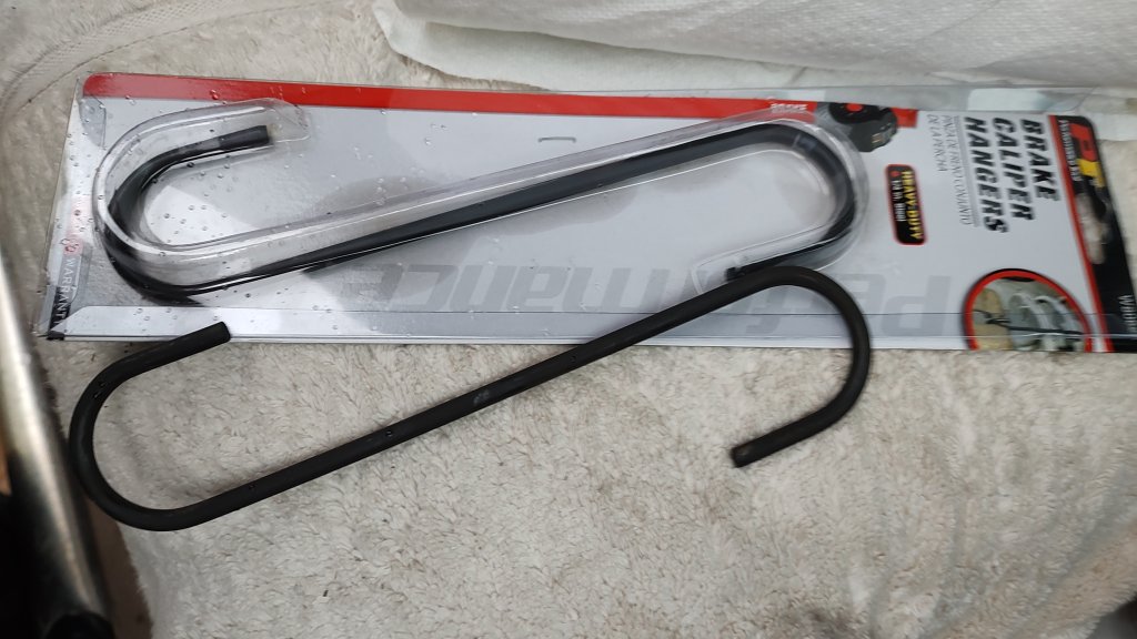

I'm glad you brought that up! I didn't know a twist in the line could case a drag either - I suspect one of the front lines on my British project has a twist (not yet been driven but doesn't look like a smooth clean loop) so I will be redoing that line (possibly both).
That is another good reason to have these caliper hangers I found at O'Reilly's. Only $8 too....

This gets me thinking… how much twist will affect it?
Depends on the length of hose and angle of the fittings. The hose has to be twisted enough to reduce the inner diameter of the hose, a "kink" if you will. The kink acts like a check valve, letting fluid go past when pressure is applied by the master cylinder but the caliper does not have the ability to push the fluid back when it is released.
