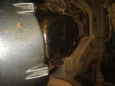

This is the line that parallels the gas fill line. Is this what allows the tank to vent vapors if need be? I remember reading something like that. If not, then what is it for? This pic is looking up at the fill line. Tank is on top. It just attaches right back into the tank so I'm stumped.
The small line next to the fuel filler hose is to vent the air. When you add gas to the tank the air you are displacing has to go out and it goes out thru that line.
See I knew there was a reason why I joined. Learn something new everyday. Thanks.

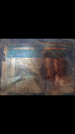

Also another question. I've been looking but I can't seem to find a solid answer and I know it's been asked many times BUT, what are my axle ratios??? Pretty sure it's Coorprate Standard 10 Bolt front and rear because it has the little tabs at the bottom of the "pumpkin". Rear end has #3896839 GM82 and front axle has #14030378 located on the passenger side on the back of the pumpkin near the driveshaft. I know that I can jack the truck up and do the math but if somebody does happen to know that would be GREAT! 1984 Chevy K10. Thanks...

I think that due to the presence of those two blocks (at 5 & 7 o'clock), you have identified it as a 10 bolt corporate - and with a 8.5 inch ring gear. Another indicator is the cover. It should have a bulge on the LH side - like a guy with a big chew of tobacco in his cheek.
So you know it's a 10-B Corp with an 8.5 ring gear. Unfortunately, that's about all you are going to know - without pulling the cover off and reading the ratio stamped on the ring gear.

Do you have the RPO code sticker on the inside of the glove box door? That will guide you to the options like axle ratio the truck had from the factory. You'll have to physically check to make sure it hasn't been changed over the years.
Unfortantly no I do not. It was taken out and the one on the fender well in the engine bay is pretty much toast. I've cleaned it up as best I can but some of it is still hard to read. PRO Code GQ1. Standard Rear Axle. Pretty sure it's stock. http://www.gmsquarebody.com/forum/showthread.php?t=4366&highlight=THM400
Found on here a list of PRO Coses but it doesn't say the "Standard Ratio", so I'm stuck...
