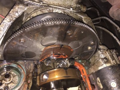

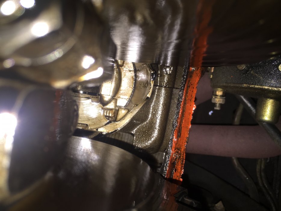

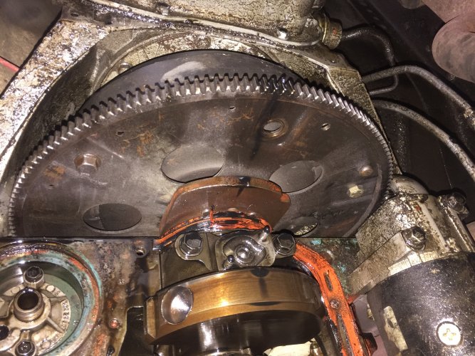

And I probably don't know what I'm looking for, but I don't see any clearancing for a longer stroke either...

Look at the front side of the balancer if there is a notch it's a 400 crank. No notch = 305/350

From the picture of the balancer that you have it doesn't look like a 400 balancer but I can't completely tell. If it is internally balanced you would still be able to see the clearancing, its supposed to look like it has just been ground down, I can't quite tell though. A couple more pictures, get a full front view of the balancer and find a cylinder with the piston up inside of the cylinder and take another picture of the bottom of the cylinder just under the oil pan surface

The one 383 I helped a friend of mine build had the oil pan rail clearanced also. I don't see that on your engine. The oil pan was also made to accept the stroke.

Yep. ^ Dude said oil pan side rail clearancing which may be accurate. The balancer differences would NOT be sufficient evidence FOR ME.
I'm pretty sure that one could simply look into the bottom end minus oil pan and see some ground areas. The number on the crank vs. the number on the block is the ONLY way to be 100% sure. Let's have the casting number near the distributor.

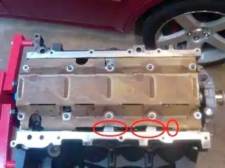

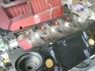

It's a sharp lookin truck - don't let it get ya down. Look at the areas of red circle, I don't see those areas photographed?

Once again, thanks to everyone for the help and input. I'm now 100% sure it's not a 383. Pulled the harmonic balancer to replace the front timing seal and crank seal....balancer part # is 3896966. 67-68 Camaro 350. Oh well...I'll just drive it till it blows, then rebuild it bigger and better.
