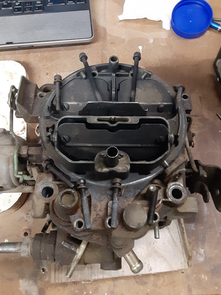

I'm in the middle of a QJet rebuild and have a couple of questions.
The carb that I'm using does not have electric mixture control (blue connector on air horn) but it's missing the black plastic insert that is shown being used in place of the mixture adjusting solenoid. Is this insert needed or something that would have sometimes been left out at the factory? Not sure if the carb has been apart in the past to know if a PO just discarded it.

From the sound of it, you have a carb that pre-dates the MC Solenoid. If so, there's no cutout for the solenoid. No insert is missing.

Thanks for the reply. My QJet has a hole that the solenoid would have fit into, right now it's just an empty space that is open to the float cavity. Some of the carbs I've seen online have a black plastic cup that fits down into the hole to fill the space.
