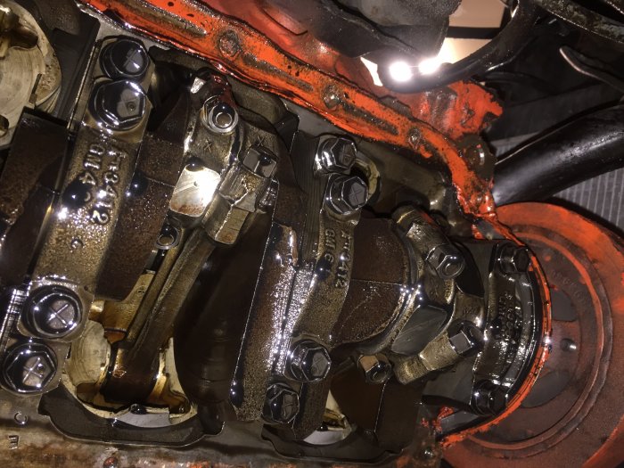

Alright everyone, got the pan off and snapped some pics. Can anyone tell from these pics what crank this is, 350 or 400??

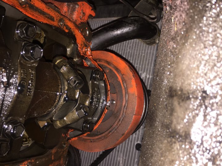

Take a picture of the bottom of a single cylinder wall, and also take one of the balancer

I can't see any clearencing done but I can say you have a 4 bolt main.

A couple have mentioned this, but the 383 is usually externally balanced, so the flex plate and the balancer will weighted and balanced to the crank.
My old 82 box has 383 I was told, but wasn't sure. I could tell by the balancer. Since you have pan off and are in there anyway, look at the flex plate and see if it has weights on it.

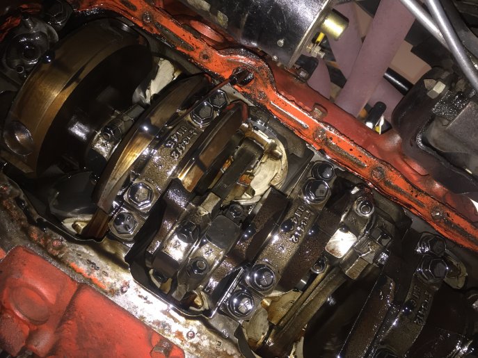

I hope I'm wrong guys, but from everything I'm seeing, there is no proof this is a 383.
