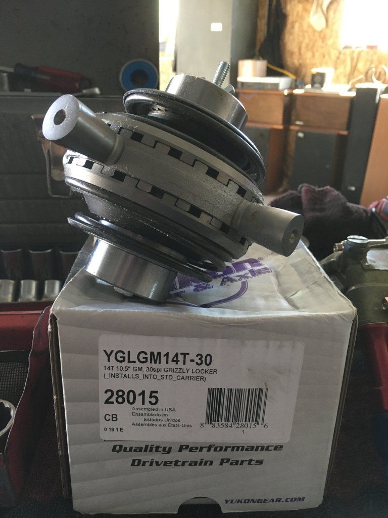

There is also the Yukon lunchbox locker, I love mine, 14 FF.
