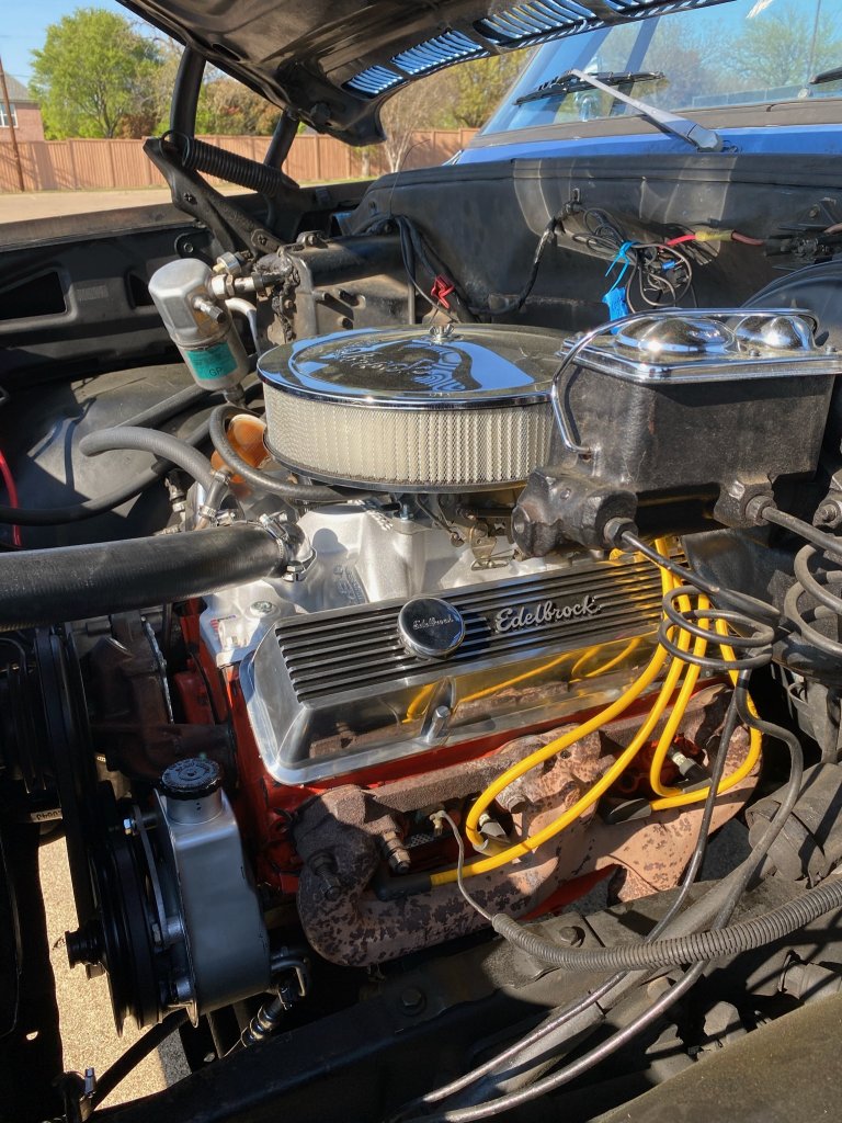

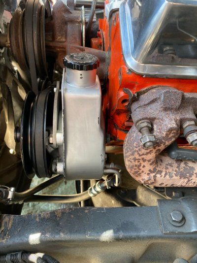

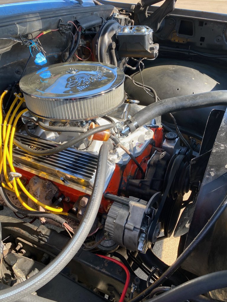

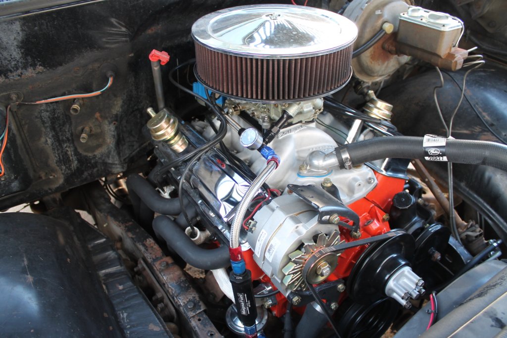

Power steering pump bracket for heads without accessory holes.
Randy and Easton
Feb 6, 2021
901
1,330
North Richland Hills, Texas
Randy
C-10 LWB
Like John says above, Alan Groves! Keith was great! And priced so even a 16 year old couldn’t complain.

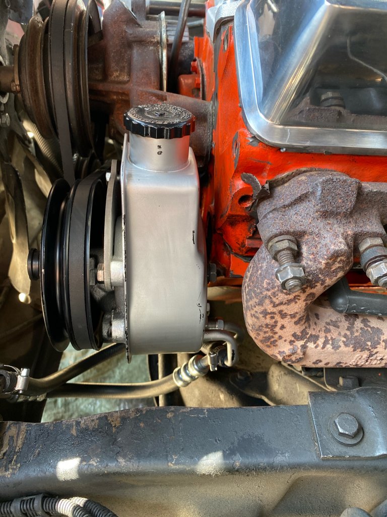

if he goes that route like you, i would get a hydroboost reservoir and cap off the extra return and then have the cap placed higher and closer to the fender a bit and it would look ok I think

So that’s a good question-looks like my pump is leaking a bit. What is hydroboost? They asked me what kind I have and honestly- just looks like a teardrop style with two lines, one pressure and one return.
Edit: I looked it up. It’s for power brakes for engines without vacuum.

That looks nice! I like the look of the raw steering pump too.

Yes, the only reason I said so is the hydroboost reservoir is slightly larger capacity, would sit the "cap" slightly higher and slightly closer to the fender(relative to the one there now) and the reservoir has an extra return port. The extra fluid never hurts and the other features are really just QOL not essential, but worth it if you had to ever replace a seal or something.

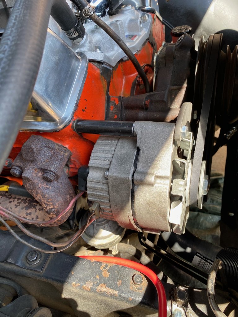

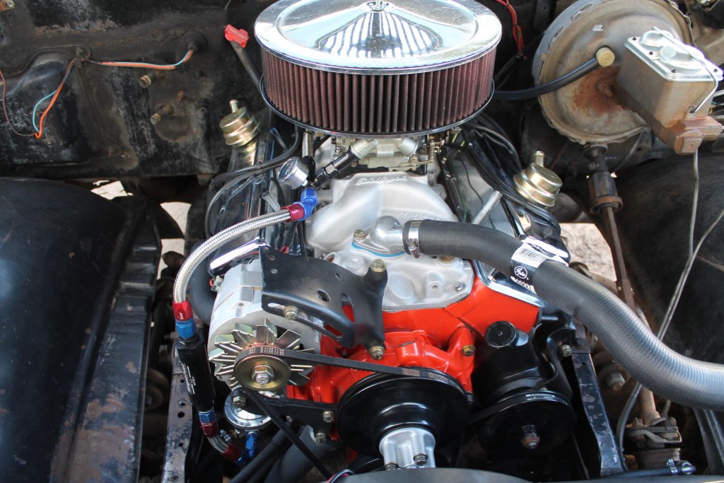

@Mark Jones Hey Mark, can you help Chad? What year and model is your P/S pump bracket from? Thanks.
!972 Nova power steering brackets, and alternator brackets, 1969 Z/28 pulleys. Works flawless, and I run it hard.

6,303
10,719
@Mark Jones what is the lower alternator bolt threaded into?
Mark Jones
Dec 2, 2018
185
533
Horse Shoe Bay Tx/Thousand Oaks Ca
Mark
327
The bolt threads into a nut behind the alternator, I use 2 brackets tig welded together for extra strength. You can actually see this in the first picture if you look hard. NO------------problem.
I thought it looked thicker than normal (phrasing oh my) lol, knew I was not insane.
