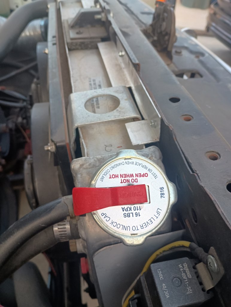

Until you release the lever it's sealed. I don't get what you're saying. The surge tank is vented anyway. So, unless the owner let the tank get below minimum at cold, it can't pull in air. Been using a lever type for decades without issue?
Yeah --- they are fine for a while.
Then they leak when the system is cooling, the liquid condenses and draws a vacuum in the system.
The LeverCap is a weak spot and every time one of them came into a radiator shop I knew very well, that the owner would come out from behind his desk, rip it off the car, and throw it across the street at the used tire shop.
I think the used tires guy was selling the old Lever caps for 50 cents. He had a lot of them.
NOW comes the big part ---> Lever Caps are not "drop-center" style like the OE as designed by GM for their cooling systems for as long as I remember --- well --- maybe the 6V cars weren't so --- but they don't count.
The drop center cap design is designed to not allow the system to pressurize until right around 160°F. Then the center valve would close and the system would start to pressurize.
This is a pressure-cycle protection for short hops where it is not necessary to pressurize the cooling system.
If you don't use the drop-center style cap, you are actually defeating the GM design that works much better than any other system in autos.
