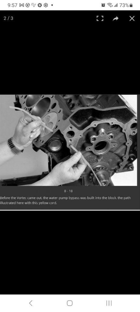

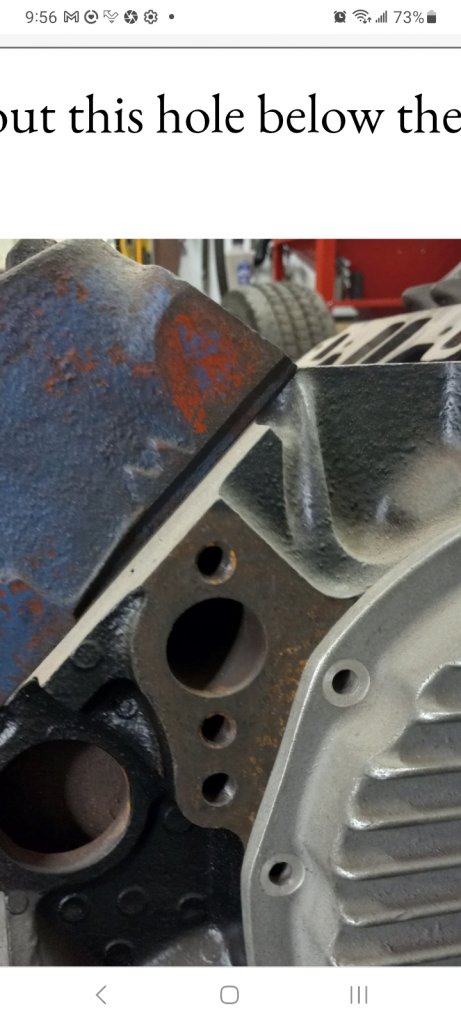

It's a circulation issue,not fan clutch,not head gaskets etc. Otherwise the 2 holes in the thermostat wouldn't have stopped the overheating. I asked about the heater core,which you answered,because TBI may need coolant through the manifold,through the heater core and then return as a bypass. When you changed the water pump ther should have been a bypass hole drilled into the block and the water pump,I wonder if the hole in your blocknis plugged. It definitely sounds like a bypassnissue to me based on drilling holes in the Stat stopped the overheating. I'd drill a single 1/16th hole in a tstat and see what happens.

I'll find a pic of the bypass hole for you,with no bypass there is no circulation so the thermostat doesn't get hot water circulated too it so it doesn't open. A singlev1/16th hole may not be enough but you can start adding from there 2x1/16th holes sneak up on it until you find what works. Biab with a bypass pic. Got you 2 pics.
