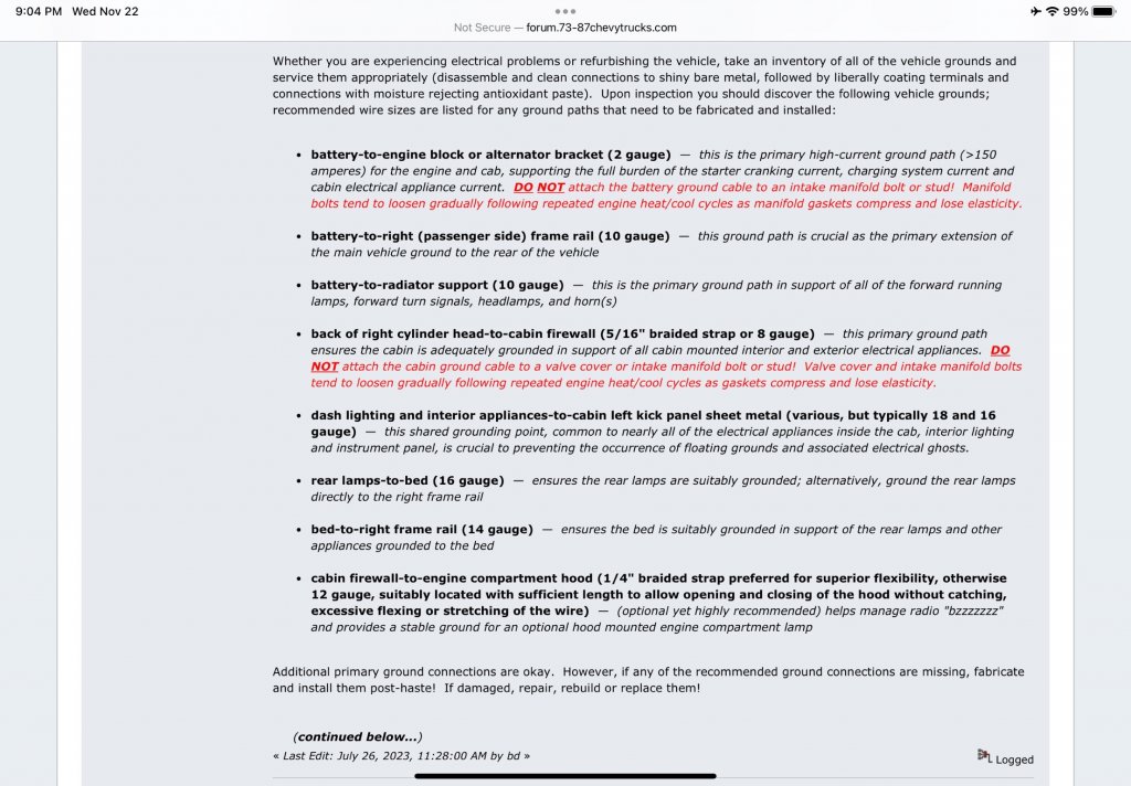

Read up on the "big 3 Upgrade"
Big 3 Upgrade

@RustyPile will be along shortly with some great advice but here is a great list.
Randy and E
