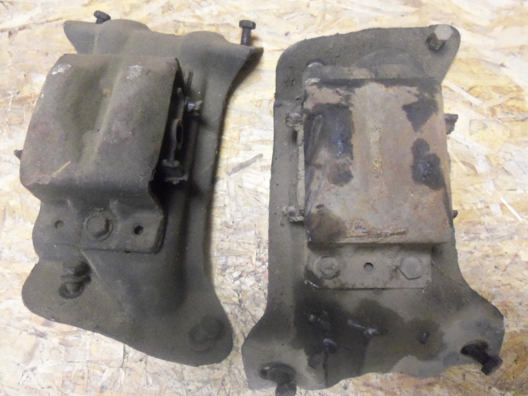

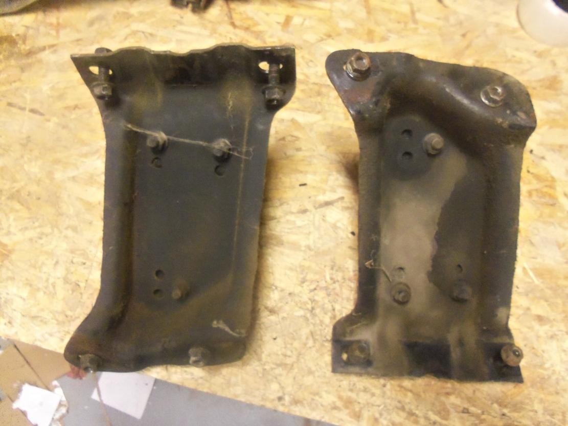

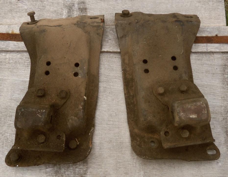

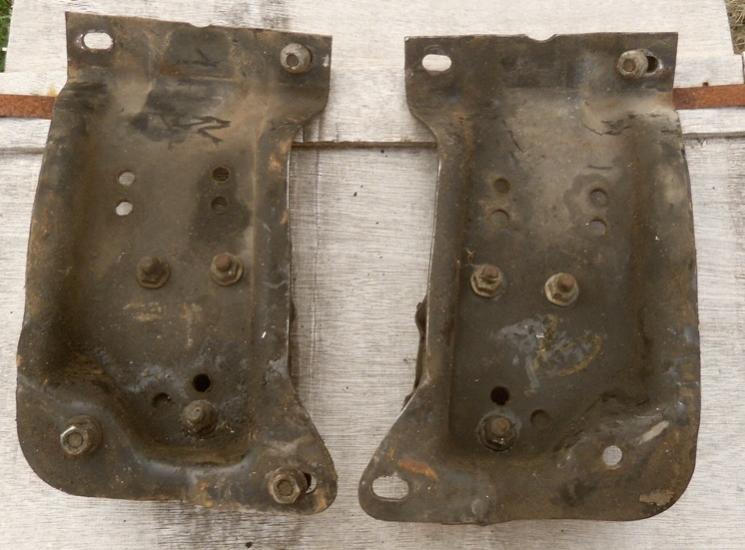

hmmmmm Wunder where this guy went. I found my olds mounts and confirmed all 4 pieces, 2 on each side, are different than the Chevy motor mounting pads. And they're not available on LMC either. Could be why they sold for $100 on eBay.
These came off of an 82 with a 350 Chevy.

These came off an 80 that was originally an Olds 350 Diesel and later Converted to Olds 350 Gas.

Now that I study these a bit more, there isn't that much difference. I wonder if the difference could be, 1 set is for 81 and later, and 1 set is for 80 and ealier? Anyone know if motor pads are different for the Round Eye to Square Eye interchange???
