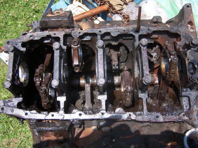

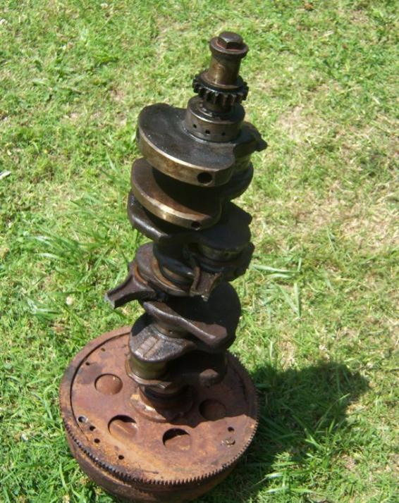

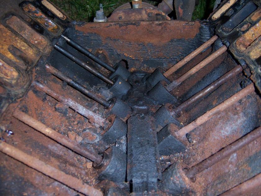

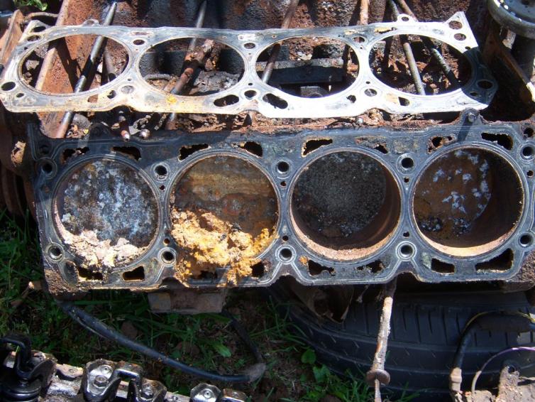

One thing about 425's, the Cranks are ALL, every last one of them, are Forged steel. I still have one that is standard grind, but needs turned .010 on the rods cuz I gouged it disassembling a seized motor. I had one one of those very rare 425's that I bought out of pasture that sat in the weather for over 15 years, with a Variable Pitch Th400. Bought both for $25 married together. Took the block to the machine shop for cleaning, he said it was rusted to bad and junk. I did my Electrolysis magic on the block, made it like a new block again, and sold the bare block for $200. Rods were junk when I cut them with a sawsall to get the motor apart. Still have the crank, trans and 1 of the C heads though. Sold the OE 67 425 Carb for $100 too.
47,128
9,299

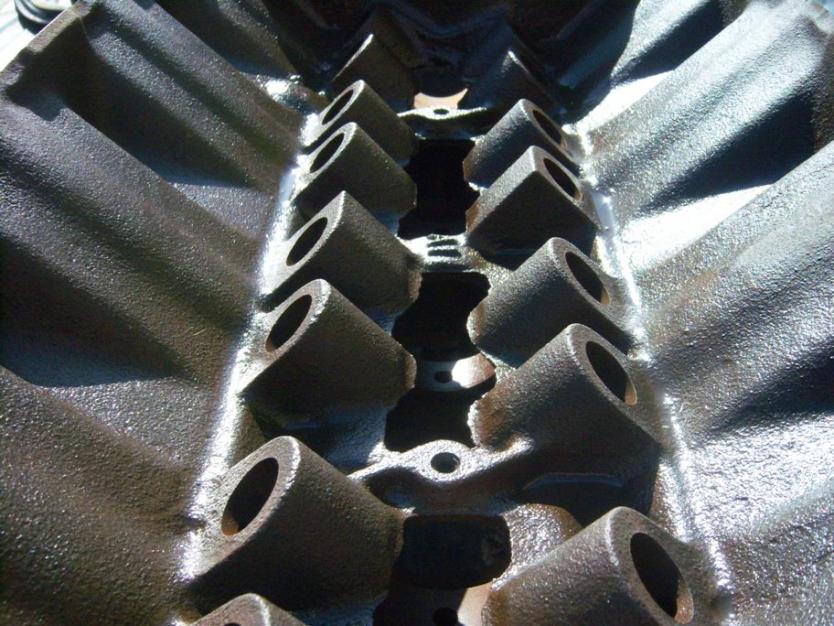

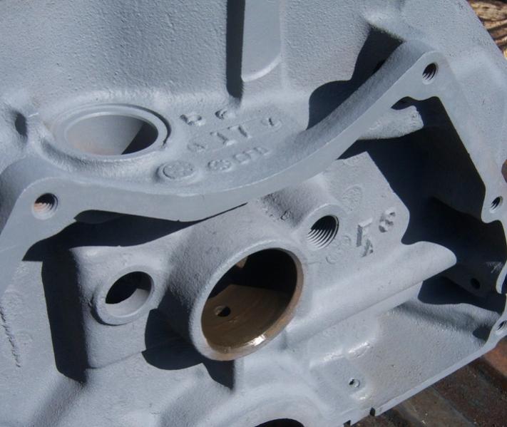

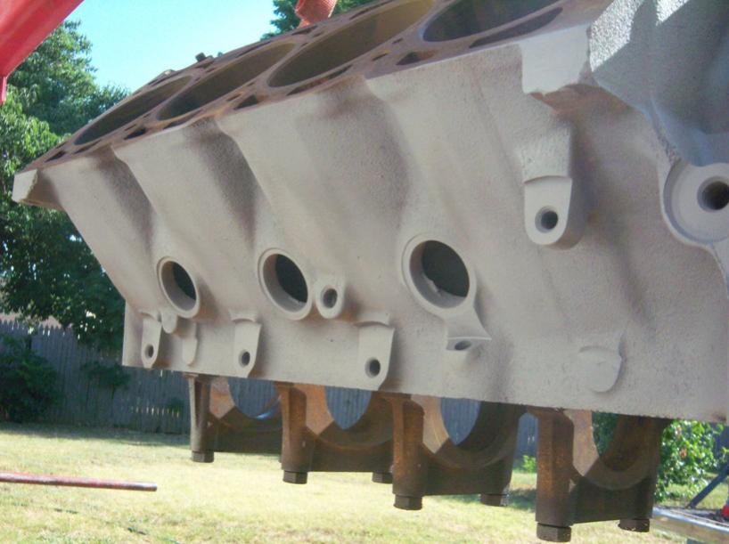

When I got done with the block and the Electrolysis, then sold it, it looked like this.

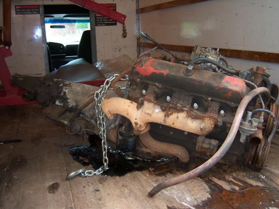

Are you wanting to put that 425 in your truck cuz it runs, or cuz you like Olds or what's the deal there? One thing about those 65 425's, they are expensive to build. They have a common lifter bore, but use a rare 45 degree cam bank angle instead of 39 degree. Also use the early bolt pattern for the flywheel. If you got lucky enough to get a 39 degree lifter angle, then you got large uncommon .921 lifter bores and the lifters are expensive. IF you want a common build, go with a 68 or later 455 or try to find a very rare late 67 425 that has the good cam angle and good lifter bore, then all you have to do is use the odd early flywheel pattern.
Point I'm making, with the raritees of the 425, it makes them expensive. I'd say you'd be better off to let that one go with the car to a true Olds guru that will keep it orginal and really appreciate it for what it is. Maybe even make you a good running 455 part of the cash/trade you sell for the car. Or does it have sentimental value that you want to keep it? You have several options though. Just saying, if you want to run BBO, I'm sure you can end up with that in a 455 to the right Olds gure.
the lettering on the air cleaner looks to me to be silk screened on it and not a sticker,, id have to go out and inspect it real close,, but it dont look like a sticker to me.....
yep,, it runs like a striped ass ape,, dont use any oil,, when it was on the road,, a quart every 3-4k miles,, and yes again i need a motor now in the worst way..
ive already put in new ball joints, new rancho shocks,, spankin new tires kelly tsr's brakes,, New radiator,, power steering pump,,pit/idler arm and so much more to list and the 6.2 pulls a diesel on me........
just to do the heads they want 2k plus part to go back together with,, and it was getting tired i know,, but didnt think it would just go without anywarning,, it did......
my family as far back as i can remember on both sides has always had Oldsmobile.. i figure the way i take car of my rides i can get another 100k out of it,, my mom has a 68 toranado 455 and we got 300k out of it before it started using oil,, so it got parked and has sat ever since,, the trans is burnt up do to a hole from a rock in the tranny pan and didnt know it and by the time she did notice it was toast...
the 425 has neve been apart except for like i said a timing chain and gears/water pump @ 75k.......
im thinking of putting the 455 intake i have on it also with the factory q-jet..
that ought a make my ole turd fly,, but mostly for dependability and towing/hauling stuff... its not such a big deal for my stuff to look old and tired,, but frame down its top notch,, paint and body dont make it go,,and never judge a book by its cover....
so far to put this motor in my truck i spent 60 sum buck for the 403 to trans-am steel mounts to chevy truck,, a hei dizzy from skip white for 47.00 and just got done getting the 442 cutless 455 olds dual exhaust manifolds off fleabay for 332.00....
all i need now is a trans filter and gasket and shortin the drive line in the truck to fit.. Sixstates here will do it for me for 25 bucks,, he does all my drive lines.. molly tubing also... and i called him up and he will even do the manifold pipes for me the the dual 2.5 inch thats already in my truck..
poor ole white truck need a heart transplant and i hate seeing it in sickley shape,, ive had the truck for close to 13 years and will never sell it,, someone would just beat it and wreak it........
im sure i would part out the rest of the car though,, or the whole thing,, but it got 4 wheeled over the trunk by my 4x4,, i didnt care the trunk section is trash anyway,, if it were any good at all id have fixed it and i fix alot of junk to be new again..
