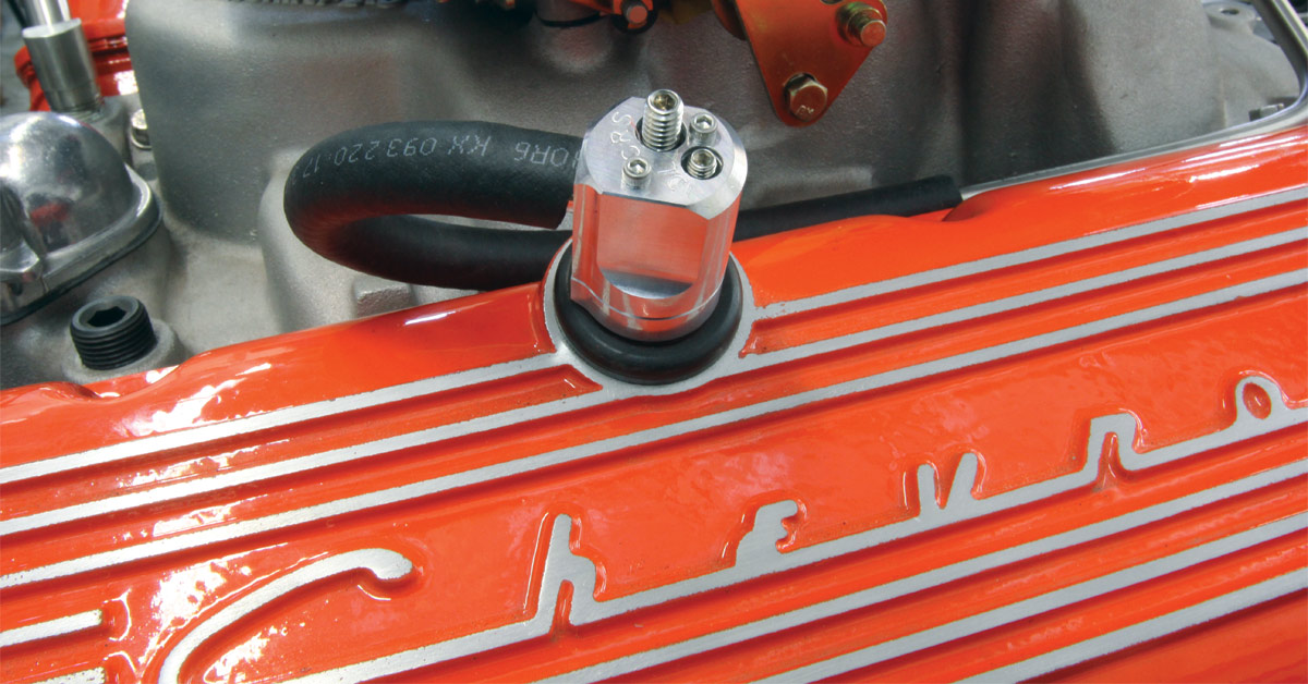

What valve covers are on it? Are they original? I ask because I've seen people change valve covers and not vent them.1 needs a vent the other side gets pcv.

Okay you probably to vent the other valve cover. I'll look to see if you posted a topside view of your engine. If not post one.

Accidentally ran across this article trying to find you a pic of how the pcv works. I recommend you read it. The manifold swap could case an oil leak especially if you didn't get the ends sealed. An intake swap won't affect pcv but I don't think your pcv is working. I think until it is working you're going to keep chasing oil leaks.

The drivers side was plugged when I bought the truck. I am gonna read this article and place an order for a breather and a new valve for sure. Thank you

Gentlemen, thank you for all the feedback. After adding a breather on the drivers side and replacing the PCV valve on the passenger side, my oil leak has disappeared. Again, THANK YOU for all of y’all’s input and suggestions.
