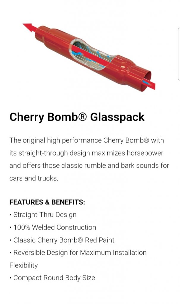

These are cherry bombs as I remember them.
31,817
32,440
Interesting cutaway. The core is perforated. Every cheap and generic "cherry bomb" I've ever used was a louvered core.
I imagine that I wouldn't like that perforated core because it may kind of have the ho-hum Magnaflow sound that I don't care for. The actual "Cherry Bomb" brand had a big resurgence maybe 15 years ago, can't say I've ever bought any of their products.
31,817
32,440
Oh, along with the louvered core, they are directional in their installation. If you install them backwards, the exhaust will be louder from what I remember.
