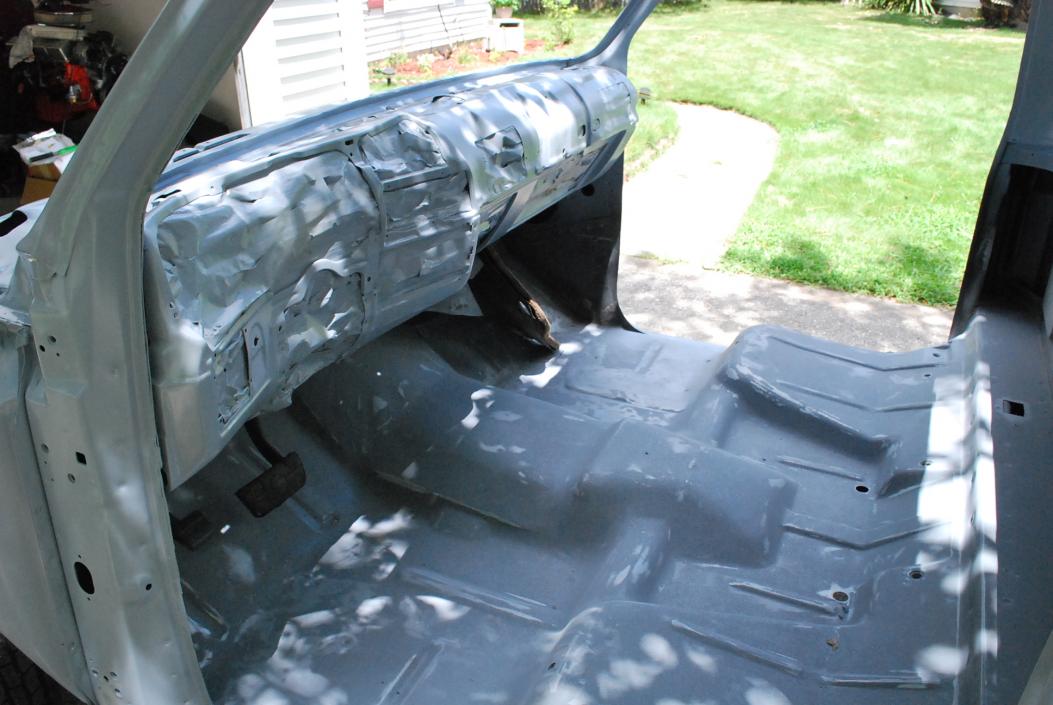

I'm assuming you use the existing hole in the interior of the cab that the door jamb switch wire goes through to route the power window harness. Where does the door jamb switch wire get relocated to? I have a '77 that I'm in the process of converting.

You will need to drill new holes for the PW/PL wiring thru the door jamb. Some say there is a dimple showing you where to drill but this was not the case on my 74.

I just want to clarify, I'm talking about the inside of the cab not the jamb. I see the dimples for the jamb should there be dimples on the inside of the cab to pass the PW/PL wiring through?

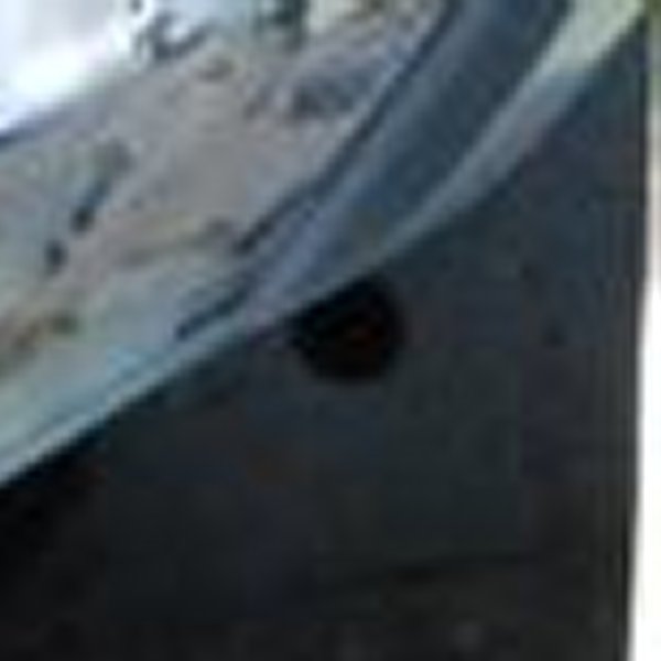

I think you will need to drill the inside hole. I had to do both on my 74. I have no idea about the dimple. Here is a pic of my 86 that came with PW/PL. Notice on the passenger side kick panel wall there is a large hole for the PW stuff. If I remember correctly the hole for the door jamb switch is higher and that hole gives you access to one of the upper door hinge bolts.

That bottom pic of a grommet is just the grommet fro the ground wire for the lights to come on when the door is opened. The wires for the power doors go up inside the cowling and enter the cab higher up just below the dash
