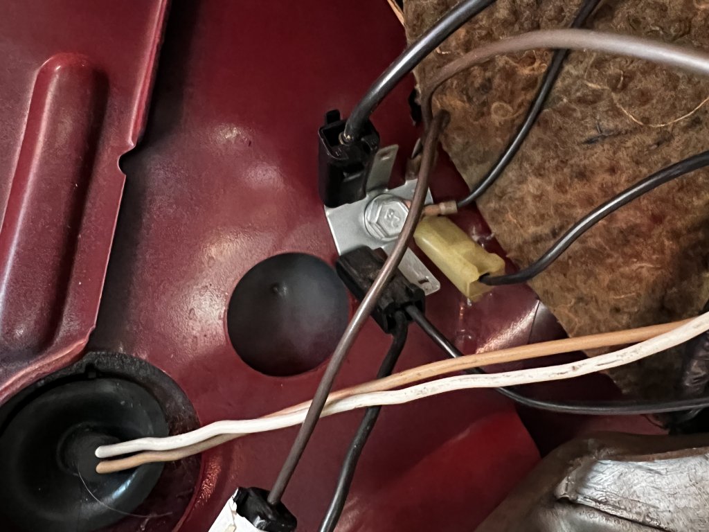

I need some help figuring this out if anyone has suggestions.
I took out my dash to fresher it up, replace the radio and dash speakers. During the reinstall I noticed when It was running, with the AC on, the windows would work intermittently. Either they all will go up and not down or just the driver front and rear would work or some times none of them would go up or down. It only affects the passenger side windows.
There is a drop in voltage when I press the switched on the drivers door. Down to almost 8 according to the gauge in the dash.
It did not do it before so I know I have knocked something loose just not sure where to look exactly. Radio is also not in.
The ground behind the dash looks clean and the wires were secured on it.
I just have no idea what to do from here.
