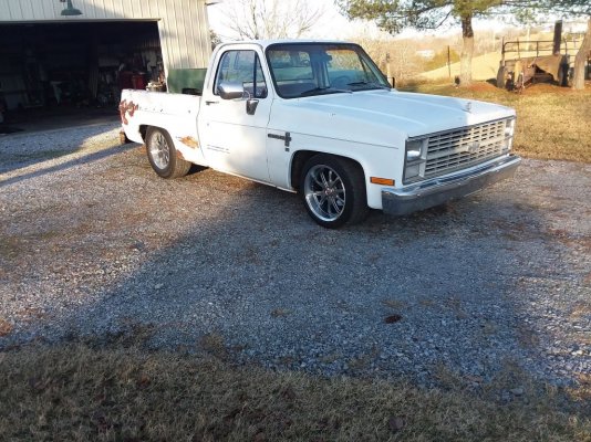

So I've got a 1984 c10 short bed Custom Deluxe. It has what seems like to me some more unusual options on it. First off it's got the good ole 6.2 diesel and 700r4 drivetrain which is a little unusual for a short bed. It also has factory air, full gauge cluster(possibly because of the diesel engine) and the interior has carpet floors and kick panels. When I bought it, the truck had been sitting for years and for the most part unmolested. I have since got it running, freshened up the interior and lowered the truck with 18 inch wheels. It runs and drives great and I drive it a couple times a week and wouldn't hesitate to drive it anywhere. With all that being said the power from the 6.2 is less than impressive. I am currently preparing an ls swap for the truck but I'm hesitating a little bit because of the trucks options and hearing my dad in the back of my head saying "if it's not broke don't fix it". In your all's professional enthusiast opinions what would you do? Ls swap or leave diesel alone and find another truck for a swap? Thanks for your time and opinion

If the truck runs good, leave it be. A 6.2 shorty is also kind of neat in that of itself . LS swaps are pretty popular fad (for a good reason) but they're not a drop-in affair like a later SBC would be. They're only economically viable if you do all the work yourself, buy the parts insanely cheap and have enough knowledge of basic fabrication, and don't have to buy all the pre-made mounts and bracketry.
If you absolutely hate the diesel, I'd suggest finding a L31/4L60 combo. It's a pretty much a bolt-in swap, unlike the LS has a decent amount of power.

I'm a mechanic/fabricator by trade so I have the skills for the swap and am able to make all the bracketry I need. I guess my question should have been "is the truck any more valuable or rare because of the options?"

While the truck is pretty neat being optioned that way, the truck will be far more valuable with a well done LS swap IMO. I LS swapped my '85 about 3 years ago and have zero regrets, it's so much more enjoyable than a small block could ever be, let alone a gutless 6.2
