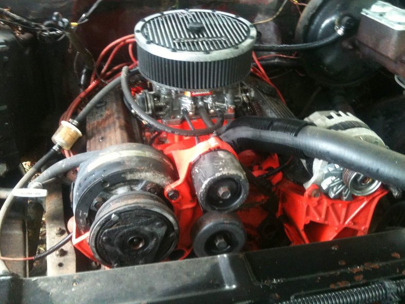

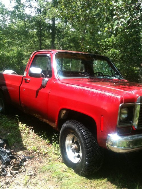

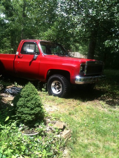

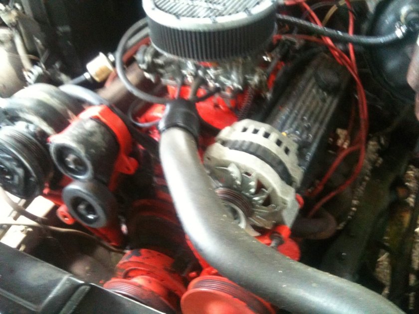

Looking for my first squarebody. My ideal truck is a 78 GMC K10 (or is it 15? still haven't figured out what the difference is, people that post them for sale don't seem to know either). Posted a thing on facebook yesterday and right away someone responded with one for sale. Here's the details, let me know what you guys think.
$1800
Parked under a tree for 3 years so needs paint
new tires put on right before it was parked (one goes flat after a couple months now, and one has a broken valve stem)
"new" 94 350 TBI motor/tranny was installed right before it was parked
rockers/cab corners are probably pretty rusty or gone but supposedly not much other rust/damage
interior decent supposedly
new edlebrock intake and new radiator right before it was parked
water pump is off
starter is not hooked up
some other piece is off that has to do with 4 wheel drive, dude says it's driveable without it but his son had this piece taken off 3 years ago to get it worked on at a shop (something about bearings or something that needed a press to do the work)
The story is it's a retired guy who's not a mechanic, and it was his son's truck. The radiator and battery went out 3 years ago, his son parked it to start working on it and then found a girl, got married, moved out, etc...
Compared to other deals on craigslist it seems like a no brainer to me (assuming the rest of it is in as good of shape as it seems), but I wondered what you guys thought. If I did buy it, what's the easiest way to transport it home (1 hour)? I can only guess I'd have to call a flatbed tow truck to move it? I can figure out a decent amount of mechanical stuff but I'm not gifted enough to go fix it in his yard in an hour to drive it home.
I'll attach all the pics I have so far. I'm not a guru so feel free to point out anything interesting you see in the pics that I haven't covered in the post so far.

With the # of add on caveats, i'm asking myself "why?".
WHY is the water pump removed?
WHY was is deemed OK to lose 4wheel drive for a couple hundred bucks?
WHY is "the starter not hooked up"? Always a bad sign.
If thats the case, no tellin what other hack-job ******** has gone on.
A TBI requires a fancy electric fuel pump as you may know...where is the computer? On the firewall?
Did the truck EVER run after the engine swap?
If yes, then maybe.
If no, then not a chance. Run.
Under a tree? Im concerned about leaking through the firewall. The floorboards may be gone.
I think $1800 is high. Way high. We are all talking about a LOT of WORK. AND A LOT OF MONEY!
Plus it's red!
That guy is spending time painting ******* brackets but didn't put the water pump back on? Bad sign.
Its got a big,expensive, ********* "elite series" air cleaner on it. Bad sign.
Why didn't they put the water pump back on again?
If its got floorboards? And you are willing to BUY a red truck? Id offer $900 IF it EVER ran with a TBI in it.
But i bet it didn't.
That's a collection of parts shaped like a truck.
That's an abandoned project. I'd keep lookin.
There ain't no such thing as an $1800 dollar, 40 year old truck that don't run.

It is a K1500. Chevy did C/K 10 20 and 30 as well as R/V. GMC did C/K 1500, 2500 and 3500. The GMC badge probably does say 15 for K15.
My opinion would be similar to all of the above including load it up. All those responses above make sense IF it's what it says it is. However... $1800 is alot for a non running truck and as said, it's an abandoned project or project that someone lost interest in for a reason.
You just have to look it over. I'd look over the frame and sheetmetal of the body very well. If that's in good shape with just the normal as to be expected cab corner and rocker rot, and the frame is good, then I'd probably insult the guy and offer $1000 expecting him to say NO, HELL NO !!! Then a few days later be calling you back up to bring your $1000 and a trailer. Buy it on the pretense that you're going to need to find another used carbed engine for it.
Also, noone has yet mentioned that sitting under a tree in the grass, there is a good possibility that mice and/or rats have set up several homes in it by now. Not sure if you have mud daubers in your area, but mud daubers tend to build nests and pull mud and dirt into every orofice possible too and they're a real bitch to get out, especially down in duct work of the AC and heater as well as that engine that's been left open. Just something else to think about. Infestation of insects and rodents kills many vehicles wiring systems too.
