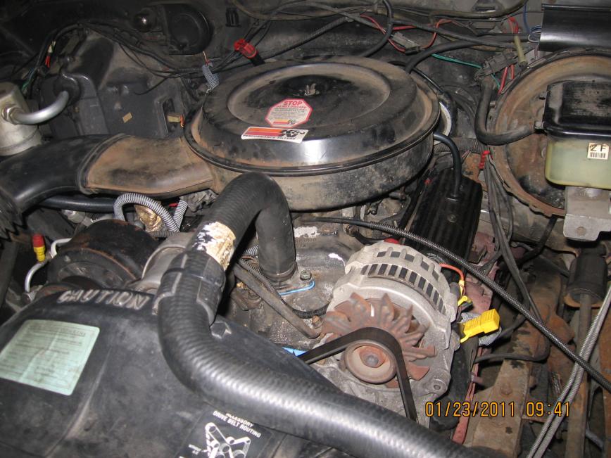

All done, FOR NOW......:flipthebird:

does it leak now?
24,852
6,861
does it leak now?
I got a seep at the thermostat gasket and the motor is still throwing antifreeze smoke out the exhaust, so in a nutshell it was a total waste of my time, but at least it entertained my buddies here.
And some of the tips and pics I posted hopefully will help somebody else who never did this before, like the bolt locations and socket sizes and ****, ya know?
Swims350
4,352
812
Logan WV
none
oh yea it should help but is there a chance your oil has collant in it and its burning off? I would have done an oil change after taking the intake off. Also as for maybe still leaking that does suck since all you would have had to do was jerk the heads off and do head gaskets. UNless the block or head is cracked. I think you can find that out with a leak down or compression test. Buy you some bars leaks or bardahl head gasket repair or block seal or something and throw it in there.
24,852
6,861
Yah, I'll throw some sealer in and I am going to get a price from my mechanic for new head gasket replacement and see what the damage will be. If it is worth it I will pay him to do it, but if not, I'll run it and get it inspected and sell the fukin thing for 500 bucks and get a different SB and start all over again....
24,852
6,861
No, I got the guage in the truck but I haven't had time to do it. And I still have two body panels to install on my next free Sunday in 2 weeks because inspection is up the end of Feb. If I have time that weekend I will comp test it and post the results. You figure I would feel a miss with a cylinder leak, this thing runs smooth as ****.
