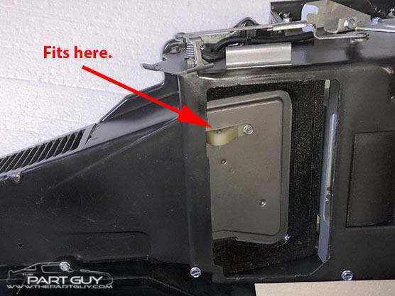

I had same issues in the past. I would strongly suggest looking at the blend door clip. OEM is cheap plastic and all 5 of my SB had broken ones. Here is a pic of one from the part guy.com. They sell an aluminum one. If you go this far get a rebuild kit and replace the seals, vacuum lines and vacuum check all of your actuators.
  • HEATER_BOX_DOOR_CLIP_GMHeaterBoxBlendAir-to-VacuumActuatorConnectorClip(5).jpg
