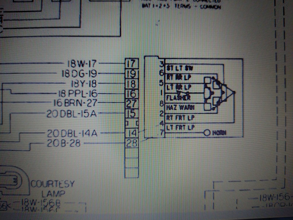

Hazards working? But turnsignal ain’t and the dash’s turn signal indicators are coming on at the same time / or staying on? Sounds like you should first make sure your lamp sockets aren’t also covered in dry n caked up grease. Distilled vinegar goes right thru all the grease ya can’t pick out with a toothpick, check your bulbs and make sure you’re using the right ones lol.
I replaced the sockets a couple of years ago, they are definitely clean. They function bright so I can't see it being a contact issue.
squarelyfe
Nov 8, 2021
174
104
NORCAL USA
Larry
k25
Either something is crossing on the back of the panel, the wiring from the panel to turn signal wiring or gotta be the switch itself. I did replace the switch a few yrs ago, but have been in there looking at my horn. The schematic looks to show one of the front lighting circuits is also sharing with horn? I was wondering since my horn isn't hooked up does that have anything to do with it.

Well, your horn has nothing to do with this. And that black (horn) wire runs straight to the horn relay connector.
I’ve tried going back and reading what the problems were but it seems like there’s an evolving list of issues. And at this point can’t tell what the current issue your having is lol.
Did see you mention your sockets are new and “clean” but are all your parking lamp bulbs good?
squarelyfe
Nov 8, 2021
174
104
NORCAL USA
Larry
k25
There is only one thing wrong I've fixed the others. Bulbs are correct and newer. The rear circuit operates as it's supposed to left and right turn signals break etc in the front when I signal it signals both sides as if it's in hazard mode. It's between the panel and the switch I just haven't had a chance to get back into it. Trying to decide whether I want to unrap and wrap back up an eighth of a mile of electrical tape off of the connection from the panel to the switch or disassemble the rest of my steering column to get to the switch pull it out and look closer at the wire that's inside. Both are a pain in the ass but that turn signal switch is newer so I don't know on the fence I may just order a new switch for the hell of it since I can get one for 20 bucks.

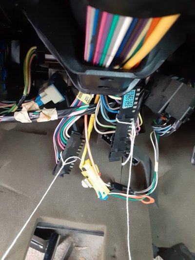

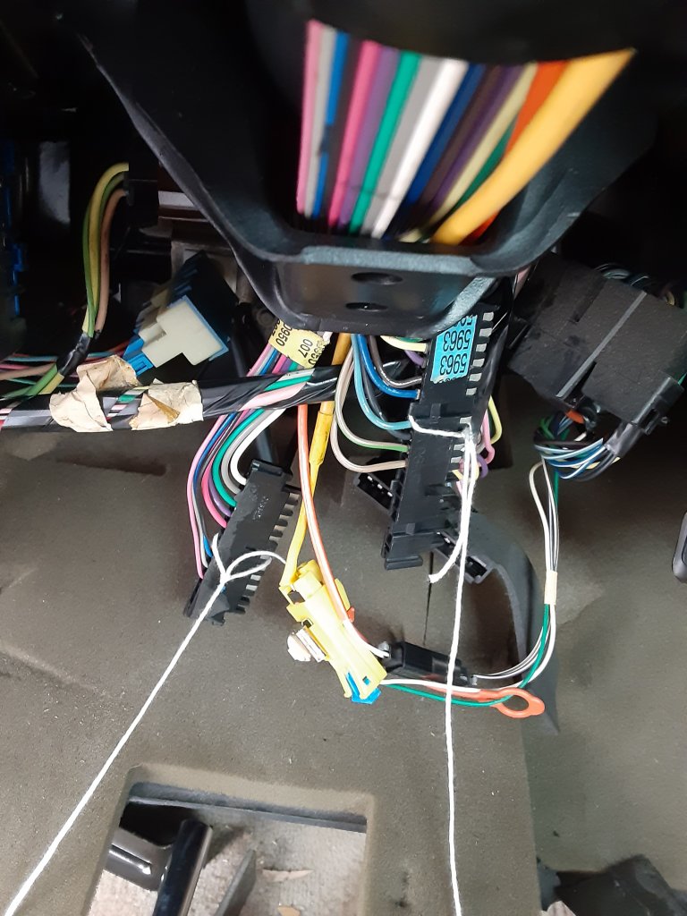

If you buy a new turn signal switch, plug it in to harness connector BEFORE you tear the column apart.
Save yourself a lot of time and hassle.
If it doesn't fix anything, why tear into the column?
Also, tie a string or wire to the connector of the old switch so you can pull that thru the column and then tie it to the new switch.
You can then pull the new wiring down exactly the way the old was.
Did that with kite string when I did the Camaro wiper switch- works like a champ.

The new switch had no effect, the same problem exists. This is really starting to upset me!
squarelyfe
Nov 8, 2021
174
104
NORCAL USA
Larry
k25
Made a firewall ground to frame and didn't fix it. How important is it for the park sockets to need to be tight against the frame I mean it's already grounded from the wire correct? No idea what happened but now I only have flashers
