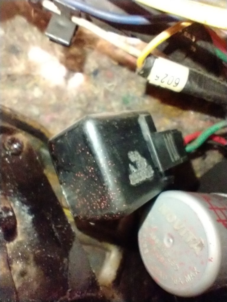

No led, I did decide to remove the Hazzard flasher relay to see if it would have any effect. I lost everything. Got it back and same stuff. Maybe my problem is between there and the cam. This sucks! What is the rectangular black looking relay box?

Raider L
Sep 1, 2020
1,892
1,004
Shreveport, LA
William
355
@squarelyfe,
Your turn signals are controlled through the circuits in the turn signal electrics in the steering column under the steering wheel. It's like changing out your turn signal cam, that wiring. You may have a break in that cam that makes your turn signals work. If that wiring is somehow damaged you'll have turn-hazzard problems. Have you messed with the turn signal mechanism in the column lately? How about the wiring that runs up the column from that wiring on top of the column where your ignition switch is. There is this flat piece of plastic that has a bunch of wires in it. You have to slip it off a metal bracket on the column to get it loose enough, to be able to pull it out in order to get to the upper column housing and move it off. All your turn signal/hazzard wiring is in there.
Have you done anything with that flat black piece of plastic and wiring on the column lately?
Pulled on it or anything?
squarelyfe
Nov 8, 2021
174
104
NORCAL USA
Larry
k25
A couple of years ago I replaced the cam switch. Being that switch controls hazard and signaling I thought the same thing. Feel like my problem is between the cam switch the column fuse panel and the front lighting circuit. Still it could be a relay ground flasher uggg. One thing that I was revisiting was on the Hazard relay. One thing that happened originally was the hazard relay tabs were loose on the relay causing a short and heating the wire so I cut it and made a jumper with clean F contact to put into the panel slot.ended up splicing a piece of wire up with a connector so I could push the prong onto the relay tab on one side. Either way my rear part of lighting is working and flashing properly I'm also flashing on and off as it should it's just not doing it in the right mode in the front it's not canceling one side. So it goes back to feeling like it's in the switch or the relay. Tomorrow I'm going to clean up one more ground that i didn't get to today. One of the chassis electrical schematics I was looking at shows from the battery - to chassis ground but that the headlight wires also grounded up front. What I have is a ground on each part of the core panel and my extra wire for ground coming off the battery going to that core being that ground isn't directional I would think that would work. I do have the cab to valve cover bolt ground and main neg strap to the block instead of the alternator bracket.
@squarelyfe,
Your turn signals are controlled through the circuits in the turn signal electrics in the steering column. You may have a break in that cam that makes your turn signals work. If that wiring is somehow damaged you'll have turn-hazzard problems. Have you messed with the turn signal mechanism in the column lately? How about the wiring that runs up the column from that wiring on top of the column where your ignition switch is. There is this flat piece of plastic that has a bunch of wires in it. You have to slip it off a metal bracket on the column to get it loose enough to be able to pull it out in order to get to the upper column housing off. All your turn signal/hazzard wiring is in there.
