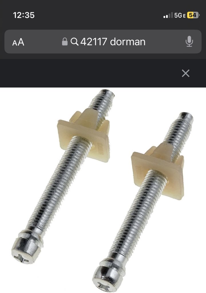

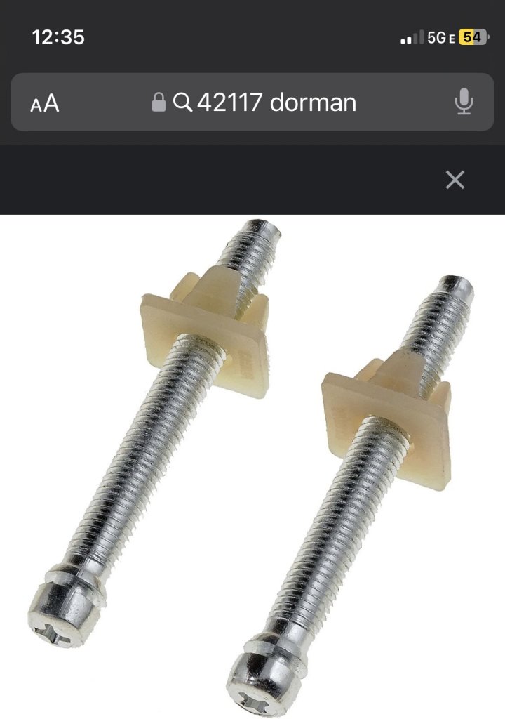

I’m 99% sure this is the part number I used.
Dorman Help! #42117
