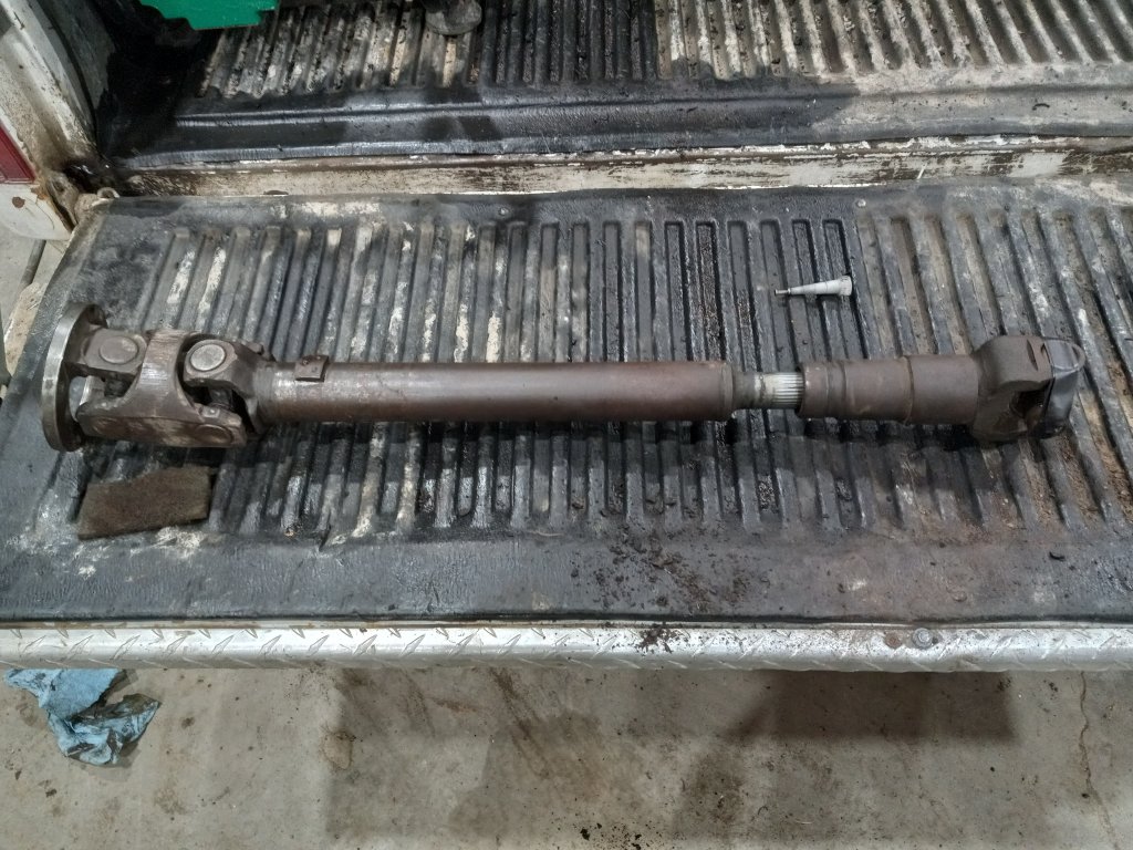

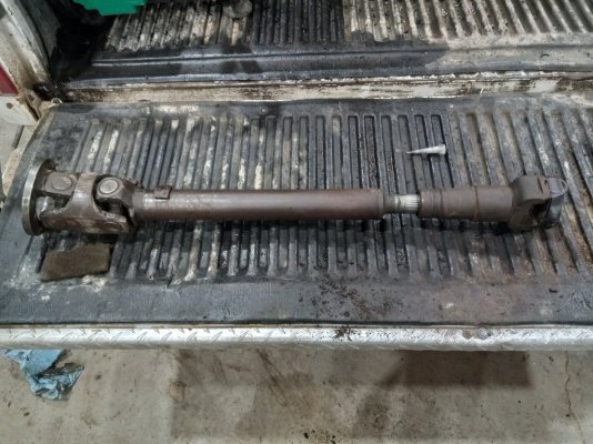

This is a double cardan 1350 drive shaft from a 1ton with a 205 t case and Dana 60 front diff Tom woods can build a custom one to fit your rig after some measurements and they are pretty cheap I believe 349 is for the 2 inch tube. I've opted for the 3 inch tube and 16 splines slip shaft to hold all the power it makes and it was 645 with free shipping and a lifetime warranty.
Sm465 gearbox with 205 and either Dana 44 or 60 front the collapsed length I believe is 24 inches plus 3-5 inches of slip yoke movement in some cases. The one in the photo is a one year only 4L80E auto 205 t-case with 60 Dana 60 front and compressed length is 34 plus 3 inches yoke travel
