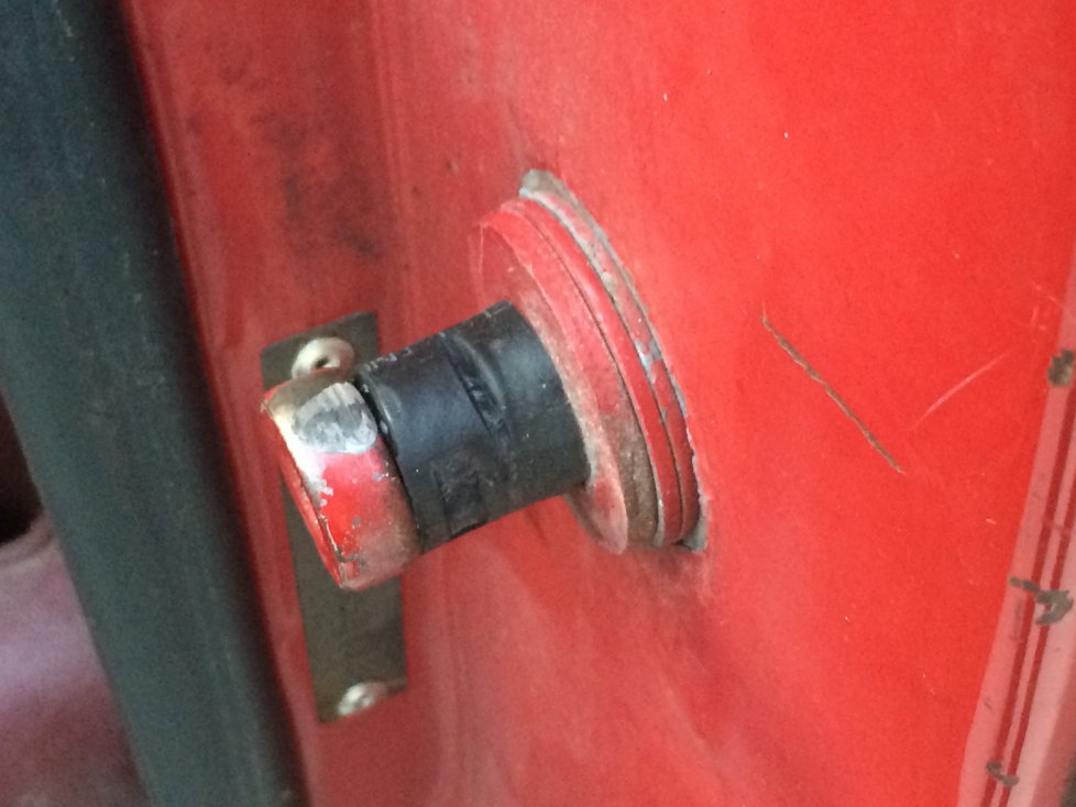

Been doing this trick for years. I have used vinyl garden hose for my strikers and have had it last years. This pic is of some heater hose I presses on after removing the striker from the truck and taking the washer off. The heater hose is a little thicker so it makes the door operation a little sticky. Just don't have an old garden hose right now.....
