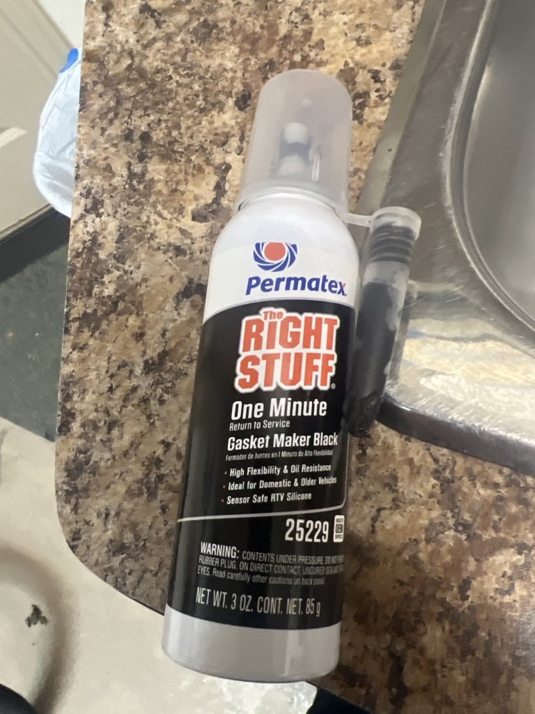

I use Fel-Pro intake gaskets...throw away the black rubber front and rear seals and run a bead of Permatex RTV silicone gasket maker instead.

Easton used no gaskets front or back just permatex “right stuff” and it’s been perfect going on 2 years
