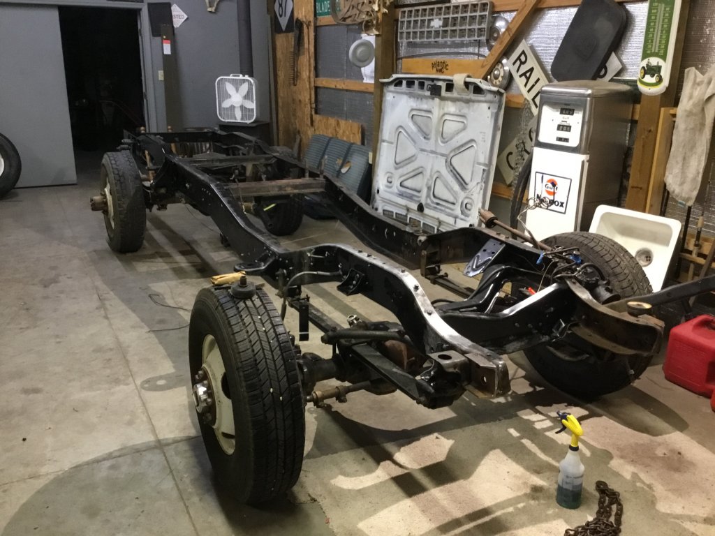

Thanks for all of the replies, yeah this started out as just find a running engine and put in the truck and go, but with the truck body and frame being in such good shape and 34K original miles and also having the body off the the frame I'm like "I might as well do it right while I'm at this point".
Over the past few days that I've messed with it, I have it unbolted from the transmission and got it on a engine stand. After cleaning it really well it looks like the oil leaks were from the valve covers and a leaking PS pump / line.
My plans are to replace all gaskets and then it will probably be "well I should probably replace the rings" and then it will be "well I should probably replace the bearings". Like I have said it ran very smooth and quiet.
Thanks

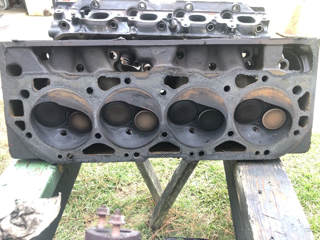

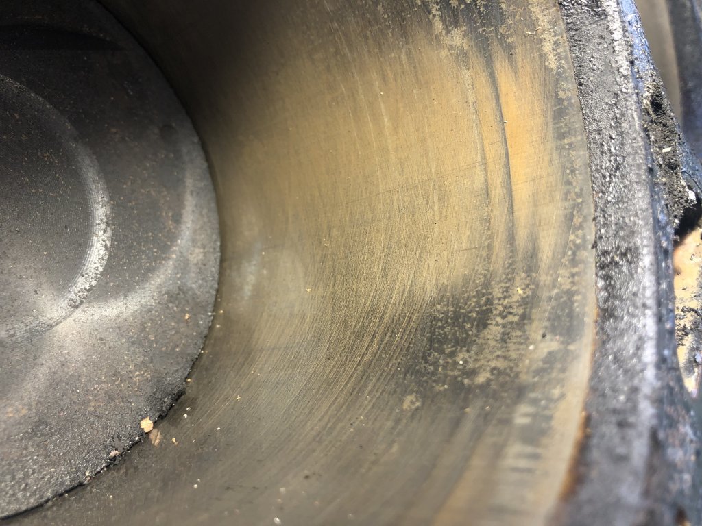

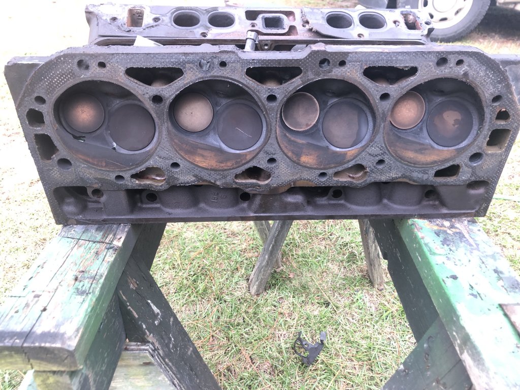

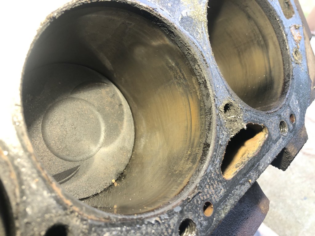

Well I got the intake and heads pulled off this afternoon. It appears to me that it may be burning some oil or maybe not as I haven't disassembled a lot of engines. There is like a dark oil like ring at the top of each cylinde Also the cross honing marks are visible in each cylinder, but it looks like I can see ridges on the cylinder wall where the piston stops at the top. (I will attach pictures)
I am hoping I can hone it out replace rings and go with it that way. Haven't looked at the valve guide seals, but like everything else on this motor they are probably brittle.

Now, if those pistons would only come up just a little more...... ;)
Byard-HWJ
Sep 12, 2024
13
17
SE NC
Herb
It just looks like carbon buildup in the upper cylinders from here.
Hey, thanks. Its been a long time since I was a teenager and worked on engines, and mostly an observer then. I'm 57 now.
The ring at the top of cylinder was a crusty black substance which I thought may have been burnt oil residue.
