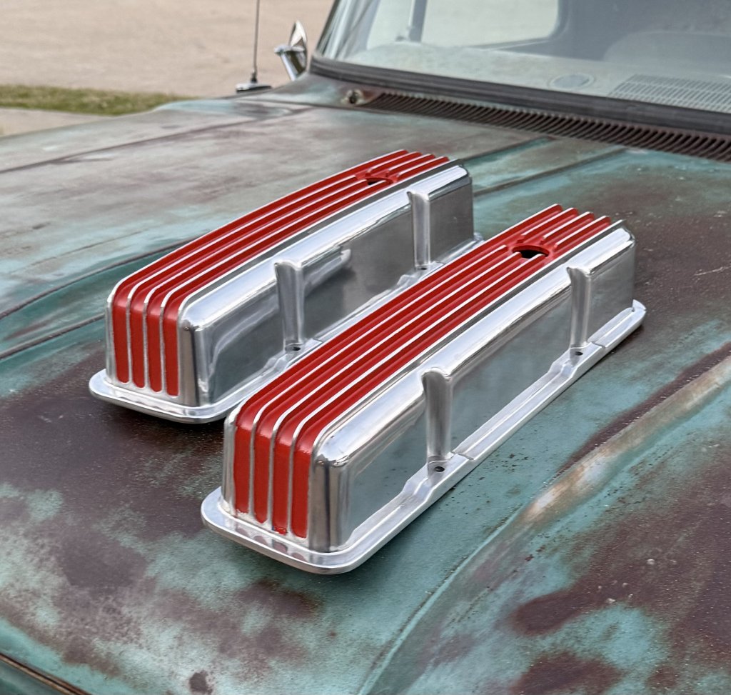

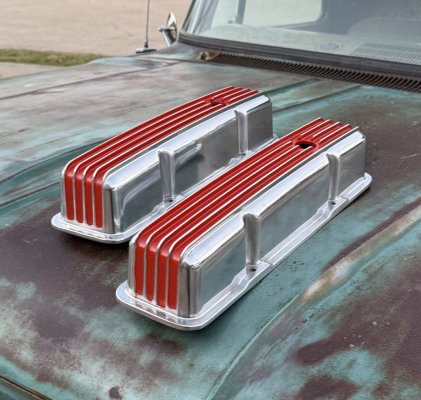

Covers came out good

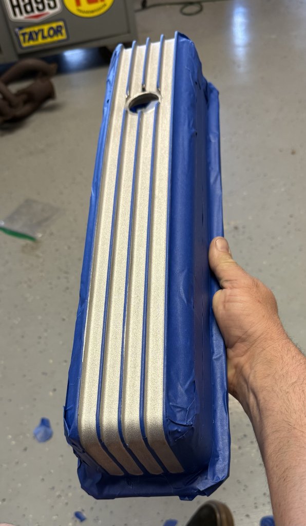

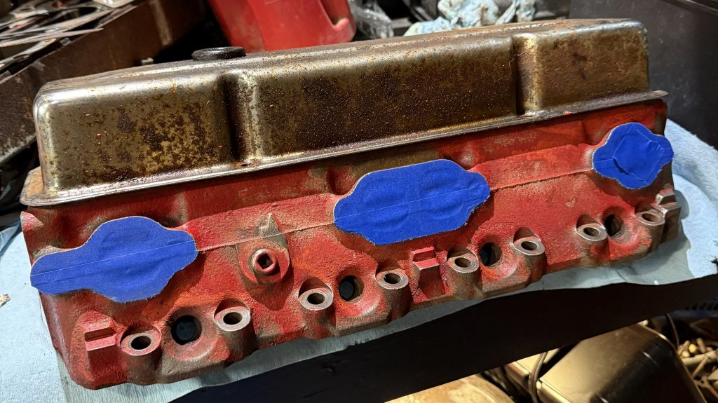

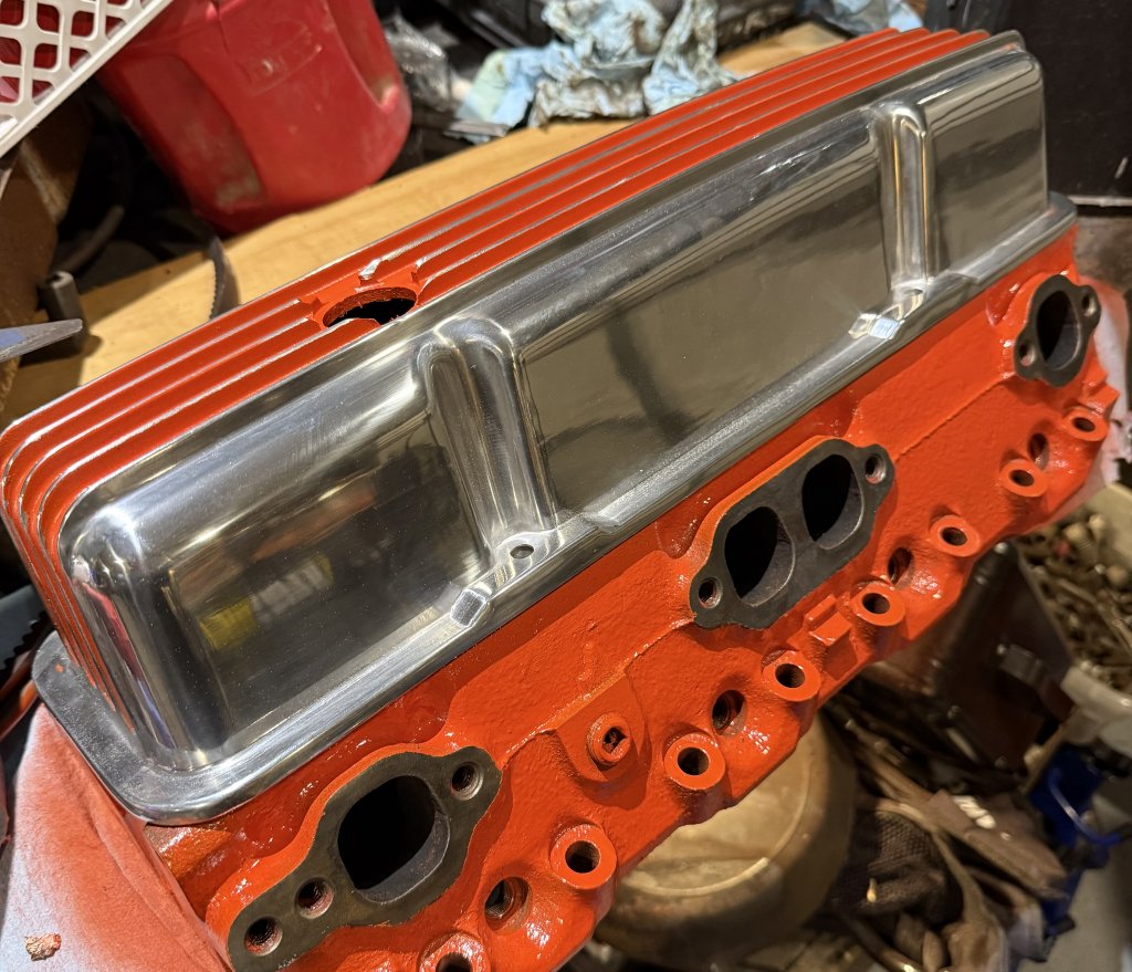

Nephew got the heads ready for paint, showed him the tape and file trick I learned from a hot rod magazine decades ago. Gonna look sweet
