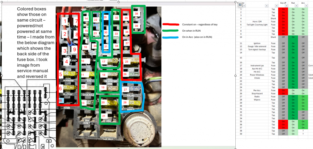

I might make jgonick’s fuse box diagram my Christmas card next year.

Not sure if this would help anybody. I pinned out my fusebox and have each identified for key off, key on and ACC. This is for a 1985 Chevy K20, stock.

Jgonick, thanks for the reference. Adding back to the forum now.
Pinned out my fusebox for 1985 Chevy K20. Took some time but worth it if it saves time and frustration under the dash. I verified all with multi-meter for each phase - Key On, Key Off and ACC. Hope this is helpful to others.
