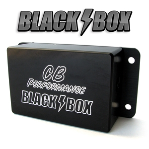

If you want to get away from the ESC system, but still want more control, look at this doo dad.
Enter the CB Performance Black Box.
While it is mainly advertised for air cooled VW's, it will operate a V8 with no problems. Read the description on the page and watch the video they provide.
It is super simple to use and install.
My kid @Maxwellvis has installed one on our VW bug and it works like a champ.
Just another option for you to peruse...

No, no one asked, but I'm glad you shared. I'm seriously interested in this and will do some more research on it this evening. I don't like spending money, but it does look pretty attractive. The only thing that would be nice is if it ran a knock sensor.
This is and has been the catch 22 for me on the ESC system. I either need to rebuild a system with a lot of obsolete parts in it, or go to a standard HEI distributor, of which I have one waiting to be installed, but with that standard HEI distributor comes a much tamer advance curve, which generally results in lack of power and economy in the 305. So for less cost than attempting to rebuild the ESC system I could run this box.
YES I know I could run an adjustable vac advance can, and change weights and springs to a similar effect, but it looks like the CB box has the ability to provide a much more variable advance curve.
I will think about this thanks!
