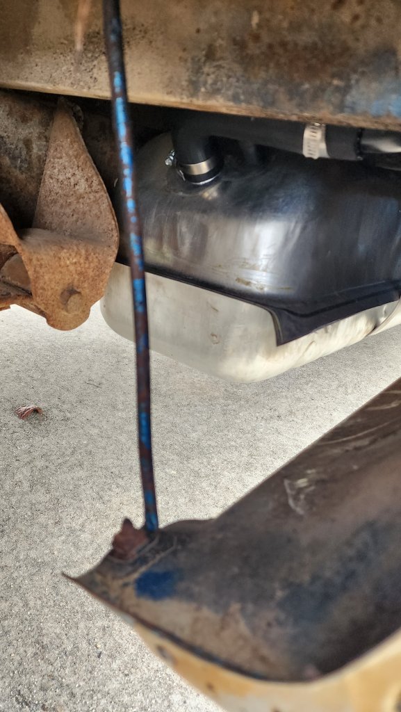

Still installing a new gas tank, it has been raining every weekend on the days that I have time to work on it.

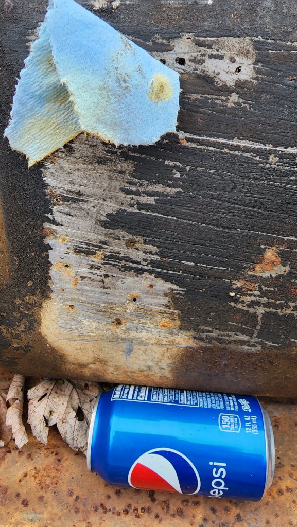

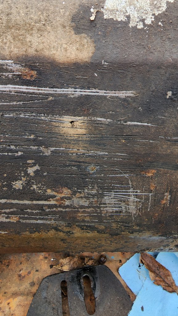

But I have rebuilt the carburator and pulled off the old gas tank, of which had holes in the bottom of it. It never leaked because it had a layer of grease coating the bottom.
But tomorrow I should have everything installed and ready to tune the air/fuel mixture. I'll have to send some pics in of the old gas tank. Sorry for leaving y'all hanging.
EDIT: checked the fuel in the tank coming from the pump, and it most definitely had water/rust in it.

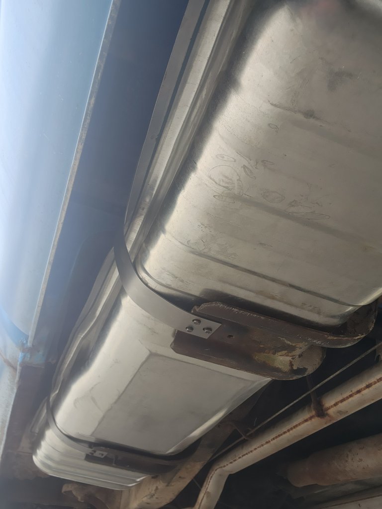

Ok, so it's very chilly outside. But great news, I got the new tank installed and somehow managed to get the carb put back together with little experience in doing it!
Put about 3-4 gallons of ethanol free gas in her. After the fuel got pumped through the lines she starts right up. Now I need to adjust the idle(spring might be too tight) and I need to learn about adjusting the fuel/air mixture. She does idle a little high by the sound of it, but once I switch her into gear it comes down a little.
Below are pictures of the old and new tank.
Thanks for all the help guys, once I wake up a little more, I'm going to adjust the carb and take her for a drive.
