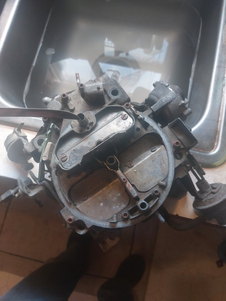

I gotta go,busy busy today look at the pic below the hole I'm pointing at if you pull off and leave off for now the big hose directly ahead and below that,then fill the carbureator through this hole,use a mustard bottle or a dish soap bottle .About an 1/8 th of a cup if you fill it too much fuel will dribble out where you pulled that hose,i just fill them till they dribble. If it starts,runs,revs feels normal for about 10 or 15 seconds. I'd look at fuel delivery. Issue's. I'll post more later.
