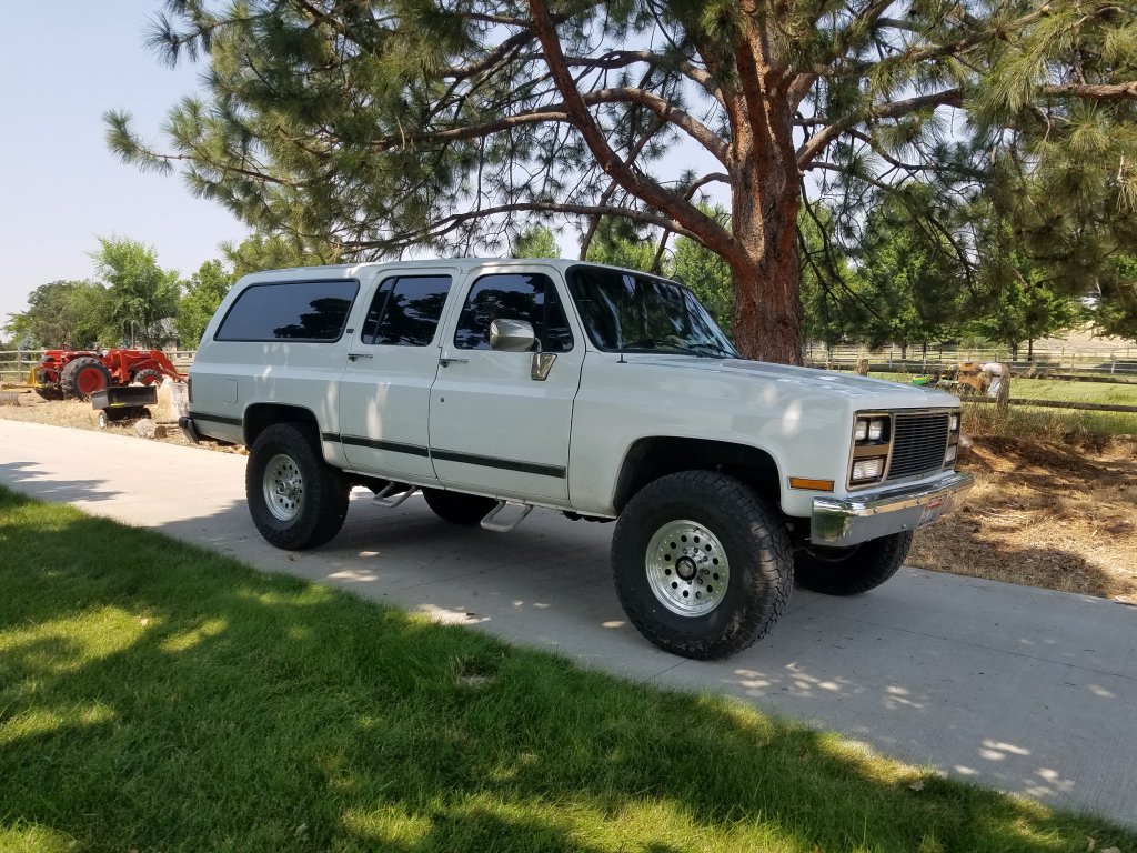

I have a 89 suburban 5.7tbi, 4L80 14 bolt and run 456 gears. I get ~12 mpg around town and ~15 on the highway. I cruise ~65.

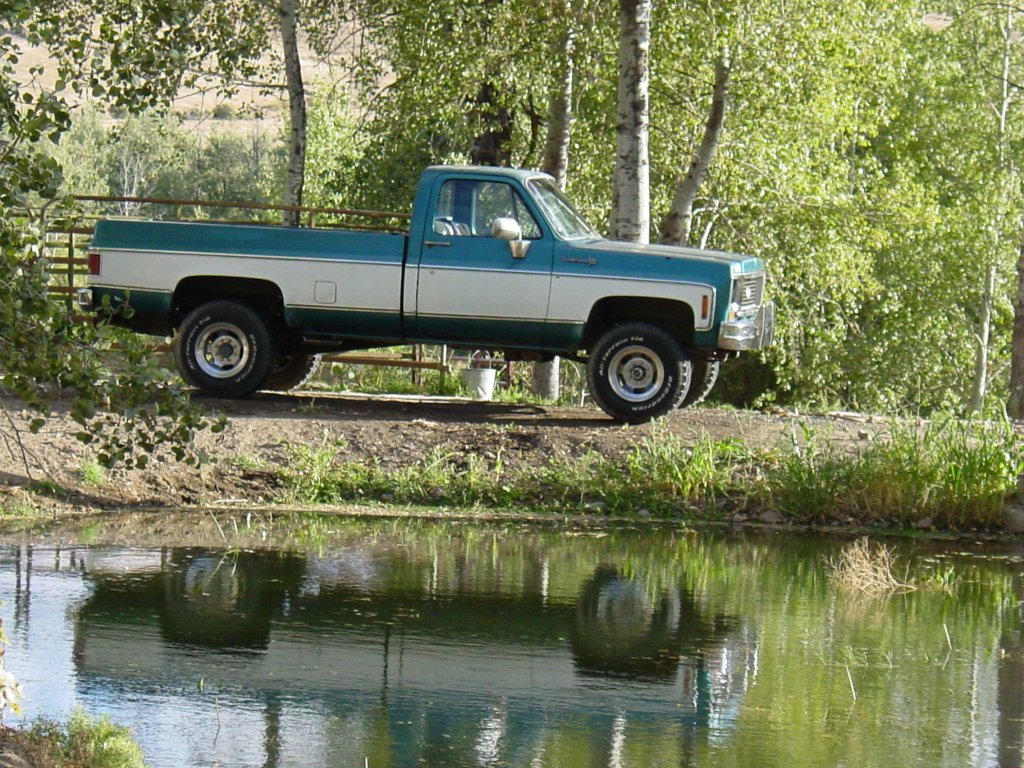

454, 4:10 205 14FF rear D44 front lockers in both. we have seep hills, truck does well here.
