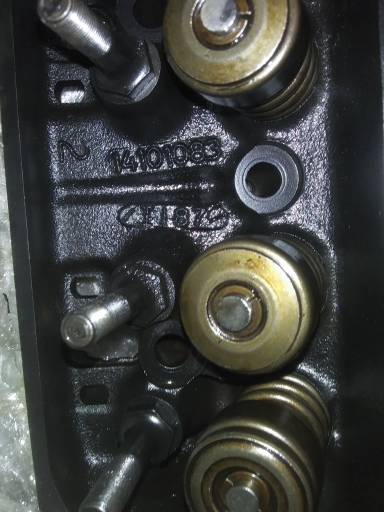

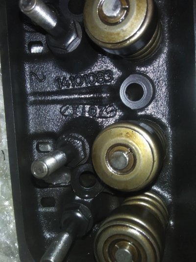

Getcha some (sbc) TPI #083 (Z-28 ,Trans Am) heads and build the snot out of them. You'll be way ahead.
:waytogo:
Yep 083.

Okay finding 292s good luck over the counter chevy hp heads,but they weren't put on cars from the factory so good luck finding some. 462s no bolt holes so aftermarket brackets, 50 year old design they'll need guides and valve seats minnimum and still won't run as good as modern heads. If you have to go old school double hump you want 041s or 186s yea 041s aren't technically double humps,but same heads different markings. Buy newer heads even just some 601s I think Rusty meant 083 heads which would be real good and wouldn't need seats installed
