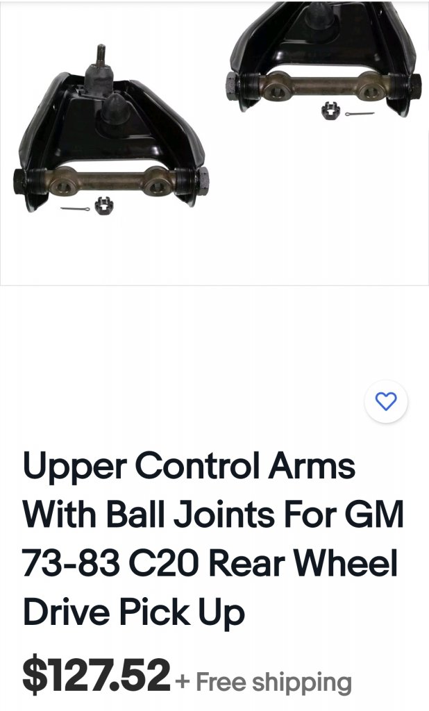

Can you show some pics of what you have now and what your problem is?!

Looks like $127 a pair ready to bolt on, from ebay..better than not running it

Thanks, but I already managed to obtain a set from NAPA and didn't have to wait to get shipped in.
I NEED that truck running ASAP.
I am fighting with doing the driver side now, the bushings in the new arm are too tight and the shaft won't rotate so I can line it up with the studs.

Well, the truck is going to be down a while longer, seems the factory across the ocean screwed up, somebody WAY overtorqued the bushings on the driver side arm, put too much tension on the shaft, AND actually squeezed and bent the arm itself inward and it hits the frame where it isn't supposed to and won't bolt up correctly.
