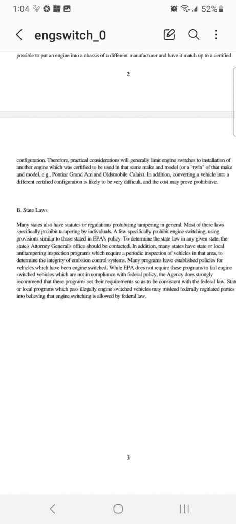

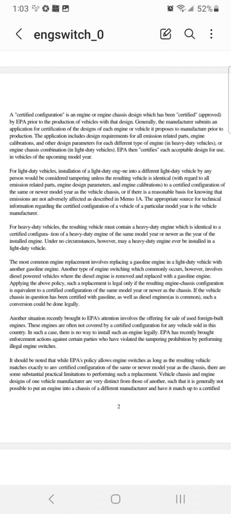

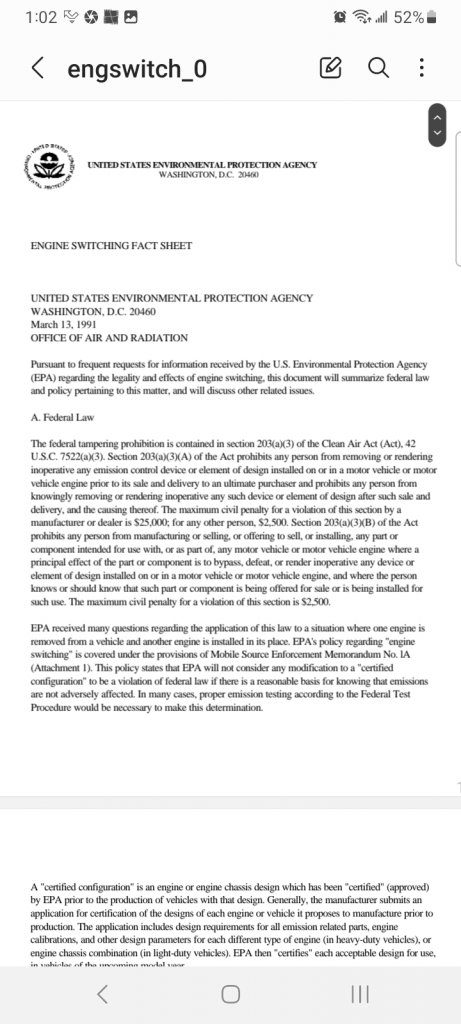

Great info, thanks all. This is my first truck, planning to fix it up, carry some dirtbikes and keep it forever.
I should add that the truck has a 305 put in it with custom exhaust. I don't think that should affect my original question, but I notice this engine was not put in HD trucks.

You need to find a more experienced emissions station, and one that will actually look up and show you the data instead of using words like “always”. Most younger (and older) guys have no real knowledge what specific emissions was installed on a nearly 40 year old truck, so having them rely on memory is not good.
The catalytic converter exemption GVW threshold changed over time, and the manufacturers changed with it. The original non-cat GVW was for trucks over about 6100 lbs, which spawned the heavy half Chevy and F150 Ford, and the GVW level for the exemption increased over the years.
Your truck is clearly one with 8600 GVW, and there should be no dispute. My Camper Special even has the GVW as part of the Camper Special emblem on the side of the cab. If an ‘86 truck at 8600 GVW did not require a catalytic converter, then the emissions guy is clearly wrong.
