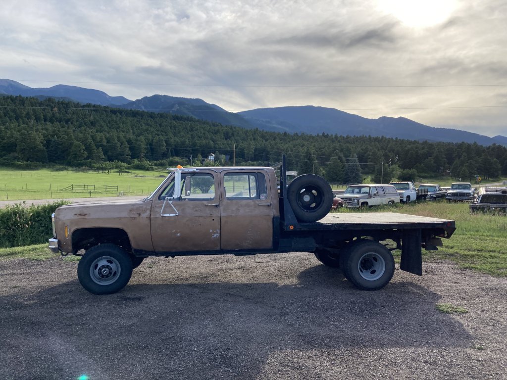

I went thru everything on my 1979 k30 3+3 before I fixed the death wobble. A good alignment shop will be able to tell if your steering has too much play or if the leaf spring bushings are too worn to stay in spec. I had the wheels n tires rotated and balanced a few times but that only seemed to help mild vibration at highway speed and didnt do much for my death wobble when braking. Replacing worn out king pins is definitely worth it. I had replaced all the worn steering parts, new bushings front to back, new leaf springs, new shocks and steering damper, new king pins, rebuilt driveshafts. Truck rode 100x better but still had death wobble when stopping at speeds below 45mph. Resurfaced the front the rotors and the death wobble went away for a week or so then slowly started coming back. What finally fixed it for good was new front brake rotors n calipers and I rebuilt the rear drums. I think the rear brakes were doing nothing and would warp the front rotors in no time. Truck never had vibration in brake pedal while braking it would just throw it into a death wobble

I like that rig a lot, very tough looking
