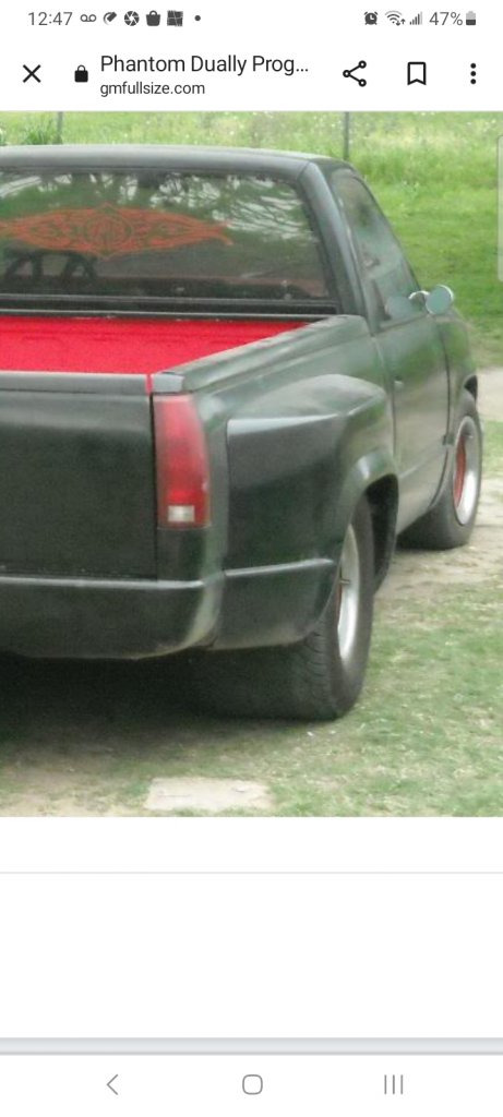

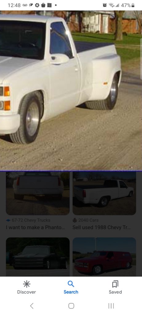

Build a phantom dually, dually bed with wide wheels and tires to fill up the dually fenders
