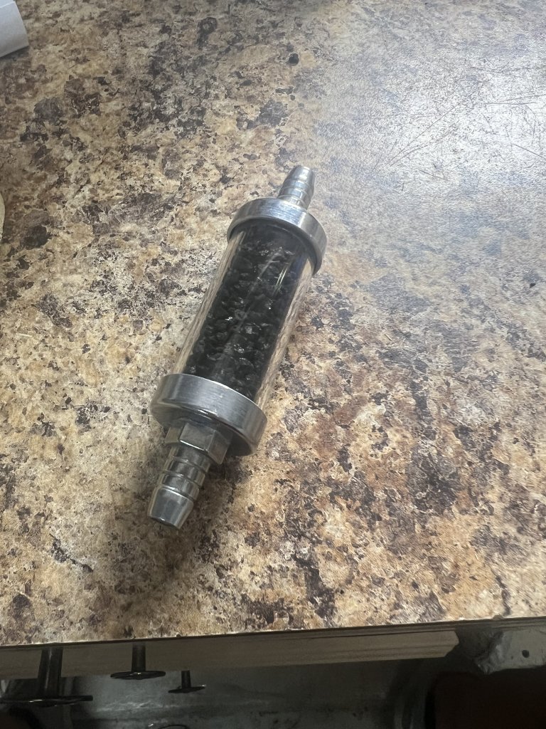

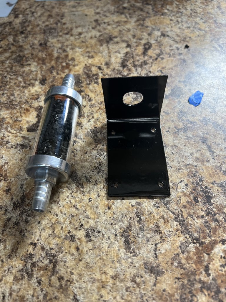

Made an interim fuel vent/charcoal filter (not to vacuum) and sealed the cap again to see if this will work while I fab up the mount for the original canister.
Will report how this works venting tank and keeping fumes down.

Nice. I'm contemplating doing something similar. I'm trying to decide if I want to do something simple like that or put the canister in and wire in a purge and vent solenoid to be run by the LS computer.
I think at this point I might just run a vent line like you have it to get rid of the constant fuel smell from my truck until I get around to doing something different.

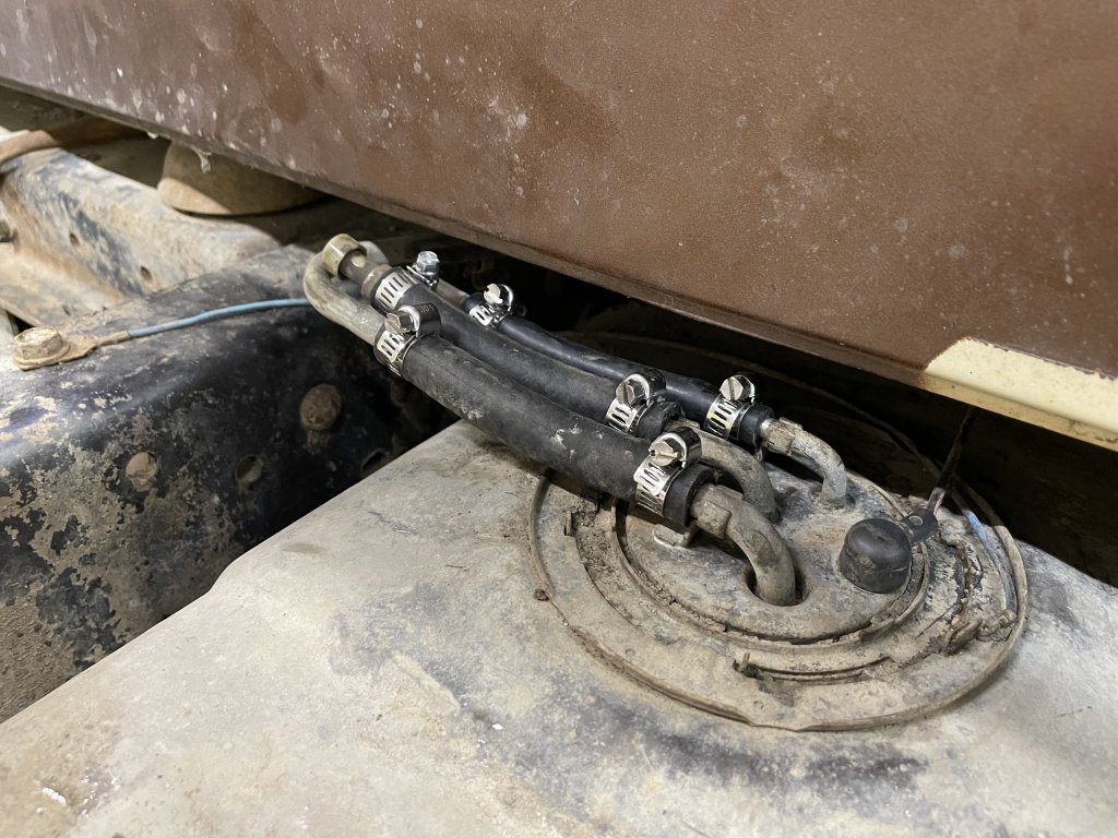

I wanted to get some thoughts on this. I had the same issue Canister overflowed spilling fuel in the engine bay on a hot day . A tech i spoke to mentioned I could take the vapor line at the tank and run a hose from that and Tee into the Overflow hose that runs beside the filler neck to solve the issue. Thoughts on this?

After a year later how did this setup work for you?

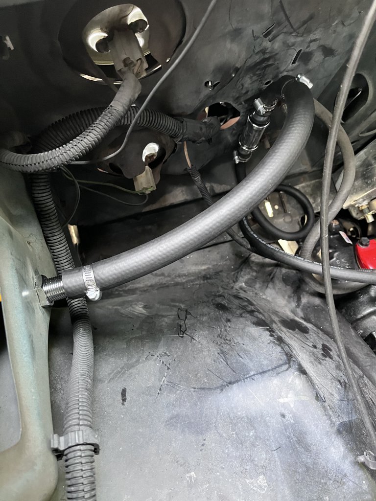

I have a similar issue. I parked the Square on the driveway after 40 minutes of driving around the town I work in and 20 minutes of driving back home. My son came in to tell me that something was leaking on the truck - it sounded like a tire. I went out, and you could hear the tank trying to vent through the cap, but it was struggling - it also has what looks like differential vents installed, but I think they might be plugged. My vent line was capped off by the PO and all the emissions stuff was removed from the motor. I plan to install small breathers (properly filtered fuel tank vents) or a canister on the vent lines soon.

If that is happening, I would say you have a purge issue. Running the T into the overflow line will make it a closed system and you would need to get a vented cap in order to prevent the tank from blowing up or collapsing

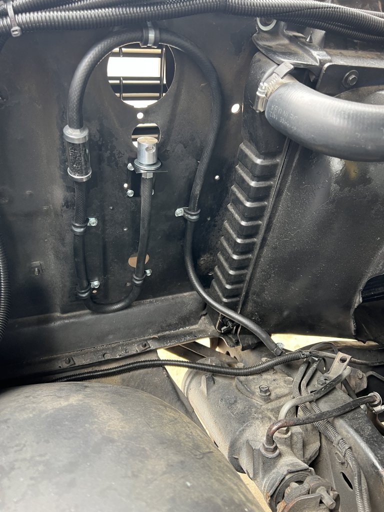

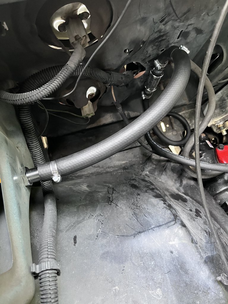

How I ended managing the purge vent situation on a squarebody.
took a screw style filter, filled with charcoal used for refrigerator air purification. Run to a boat style vent tube that fit perfectly into the driver side fender that already had a whole factory drilled. Use at your own risk, this capture the hydrocarbons in the charcoal and is easy to refill if needed. Also the purge vent on the end used on inboard boats help with venting.
