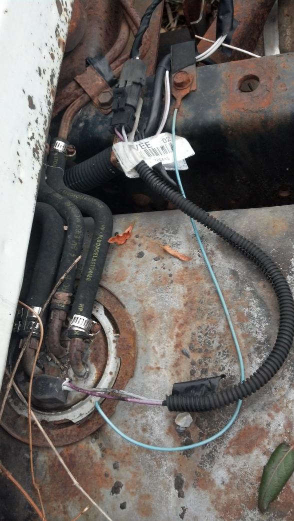

I hate to be a pain. But which relay is the pump relay? Can I just unplug the harness at the tank and run 12v to one of those pin? Im not referring directly to the sending unit pin, but the 6" long harness attached to the sending unit
Like I said, bed is off it so I can easily just hit the harness at the sending unit. Just need to know which wire is for the pump and which is for the fuel gauge

Yep....its the tan wire with the white stripe.

Hmmmm....lol can u try again.

At the sending unit, pink is for the fuel gauge, brown or gray are for the pump (depending on which side you are looking at). The tan/white stripe Jim is talking about goes from the FP relay to the switching valve, if I remember correctly.

yeah... foamy is right, i didnt know it was dual tank. The red and white wire at the relay is for pump testing.
