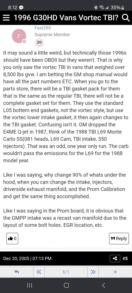

There is a rumor that 1996 express vans? Or box trucks? Marine engines We're a bastard child, vortec head, factory tbi injected engine. Look at some gasket set listing's to verify, as in 1996 truck intake sets, look for one for a 1996 TBI truck,that could point in the direction of a straight bolt up including the throttle body and an appropriate computer. Hopefully a factory manifold and tune wouldn't have the cold fuel separation issues after market manifolds have. Okay did a little snooping on the internet seems the unicorn GM TBI vortec is 1996 G30 classic van. I've never seen this intake,just heard tge rumours.
