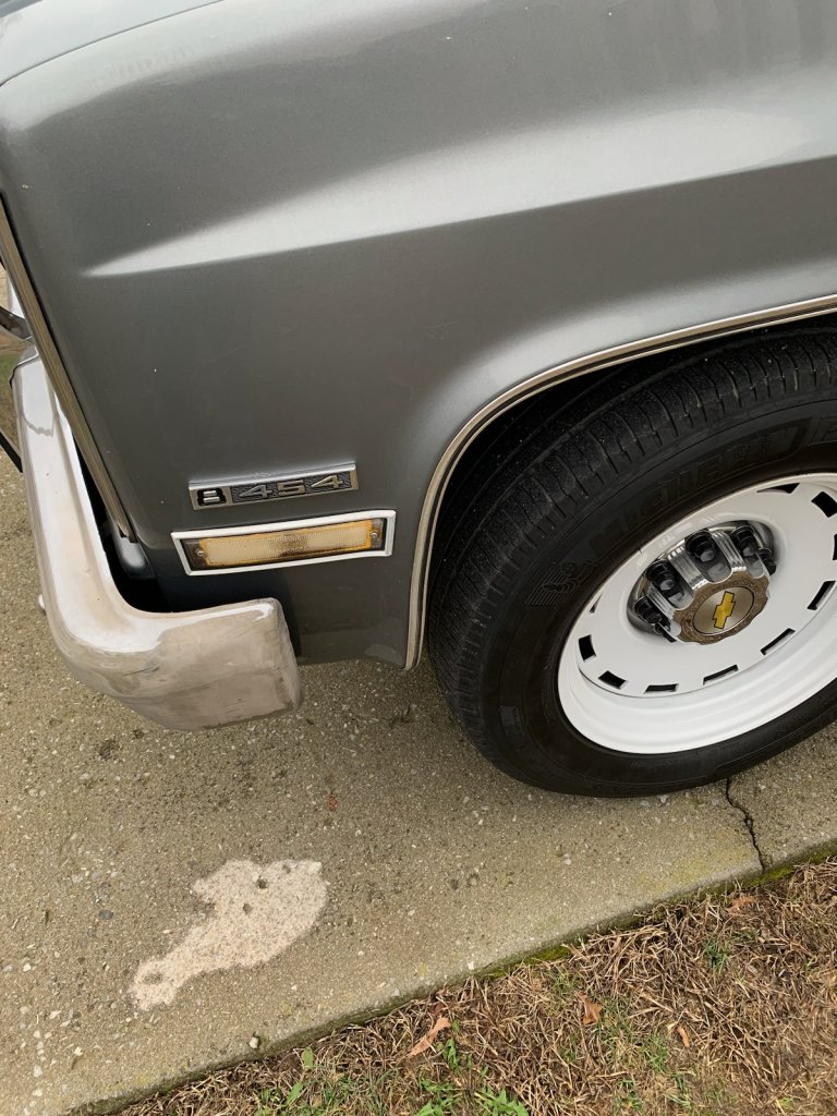

Well shes mine. 87 model fuel injected 454 truck...
Nice truck! The solid color with the classic GM white roof looks especially nice.
I was just going to respond to you that nowhere near Mississippi there are lots of C20s for sale up here. From beaters to trucks that look as nice as yours.
Not to mention a very nice C30 dually that hasn’t sold for a while.
Was that truck rockin the Detroit Steelies when you bought it or did you add them?
