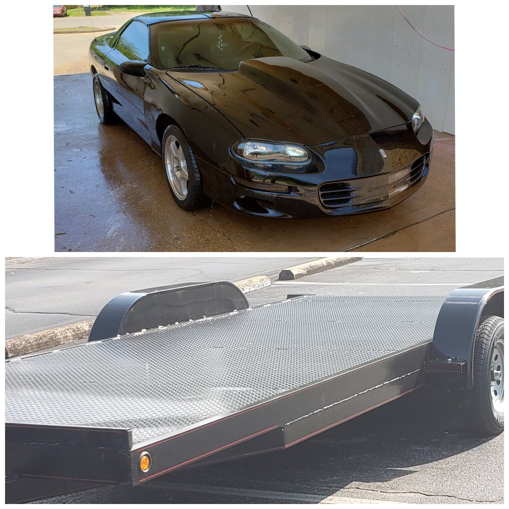

I have several questions. Im new here as well. First post
I gets a profit share bonus in Feburary. Im go be in the market for a C20 pickup. However, i do have some expectations out the truck. I have a camaro and a 20ft car hauler that i will tow to big stick shift races.
I was go source a cat eye truck but a quick look into marketplace i notice something about the 5.3/4L60E trucks. The tranmission always have issues and im not a fan on sensors anyway so im going old school.
I will be towing sometimes 400 miles or so one way to race my car.
What engine and tranmission would/should i be after in a C20 to haul my car and trailer with ease?
Also if anyone have a C20 for sale i will interested in taking a look at it...
Here is a pic of my car and trailer
