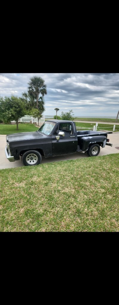

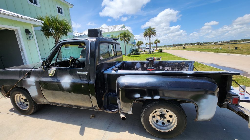

Can't say without more details. Need to know backspacing and offset. Also, throw up a side picture of the truck to show how much clearance you have as the truck sits (side on shot with the wheels straight). Higher backspacing tucks the wheel further in, lower backspacing pokes it out. So if you have too high of backspacing, you run the risk of hitting the fenders when turning if you go too big on tire size, backspacing changes your steering arc.
Here how it is right now before lift.

What abt after lift?
Can't say till it's lifted and you can measure. Won't be able to know if you'll be able to even use the wheels, let alone what size tire you'll be able to run until it's lifted and you can measure. Remember, there's so few lifted 2wd C10s, there's alot of unknown here

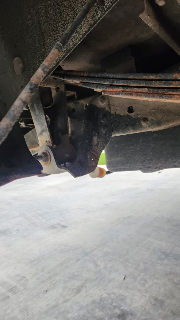

So I was just looking around at me rear leafs and I saw something odd(in the photo)
My truck seems to have alrety been lowered and leveled.
It's 29.5 in the rear and 29" in the front.
I guess fixing whatever that is will be on my to do list for this weekend.
I could also just keep it and put corresponding blocks to whatever lift height I get on the front.
Maybe you could move the lowering kit from the rear into the front??
