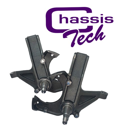

So I could get new springs(I'm guessing more beefy ones?), control arms. Then get a 4.5" lift spindles like this:
I'm assuming I wouldn't have to do the obs ball joint swap thing and could just go with the joints alrety installed into the control arms?

I would look for a lift spindle that uses a hub and not tapered roller bearings. Will live a lot longer. You cannot scrimp on bearings with big/ heavy wheel/ tire combos.

Nope, don't get "beefier" springs unless you want it to ride like crap, keep the ones you have. Get good quality replacement control arms and add those spindles. No, you won't need to do the OBS balljoint swap. That was only done back then because there literally were no parts offered to lift a 2wd squarebody until recently
